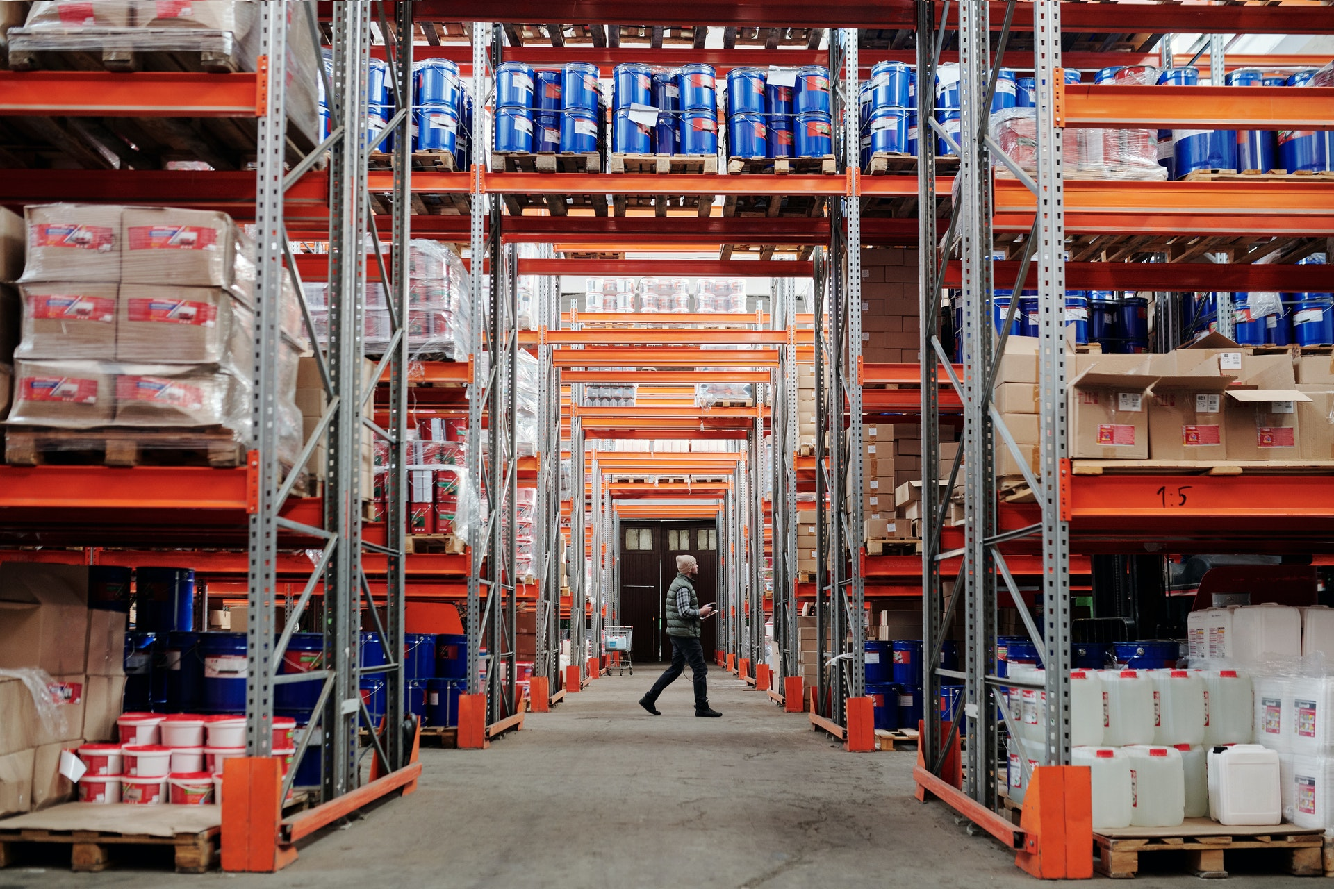

Now that you know that every area in the warehouse needs a custom lighting solution, focus on finding the right locations for each luminaire to ensure an optimal layout. Failing to appropriately layout the space could easily result in non-uniform light distribution, poor visibility, and glare. Complete your lighting layout plan well before you begin work to avoid this risk.
Choose locations that illuminate the entire area uniformly, thereby helping the workers perform their tasks efficiently. For example, placing luminaires on the ceiling above storage areas could create shadows or dark spots once materials begin stacking up. This can lead to accidents in the workplace. In some cases, placing luminaires over the top of the shelves will be beneficial to illuminate the racks.
Similarly, the aisles should be properly lit as they are frequented by heavy moving equipment, such as forklifts, boom lifts, and hand trucks.
