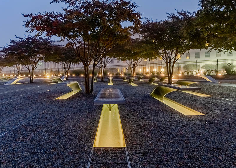

The National 9/11 Pentagon Memorial, a two-acre park adjacent to the Pentagon, is dedicated to the tragic events of Sept. 11, 2001.
The National 9/11 Pentagon Memorial, a two-acre park adjacent to the Pentagon, is dedicated to the tragic events of Sept. 11, 2001. Each of the lives lost on American Airlines Flight 77, and military and civilian personnel inside the Pentagon, is represented with a bench and individual rectangular pools under each one.
In the evening, the benches are illuminated from below by lighting installed within each pool, providing a striking visual effect while clearly identifying each bench location. When the park first opened, the pool lighting fixtures were HID. According to Giovanni Santoro, project manager at Aarow Electrical Solutions, water had been infiltrating the fixtures, causing lighting failures in recent years. A lighting retrofit was required to make sure the memorials were appropriately illuminated in a safe, low-maintenance and energy-efficient way.
"Due to the sensitivity of the site as a national memorial, the solution had to ensure minimal disturbance to the site and respect the memorial design elements," notes Santoro.
Aarow collaborated with Federated Lighting and Graybar to develop the new lighting specifications and selected Hydrel's 4426 LED fountain and reflecting pool luminaire for the project.
With a medium flood distribution, light coverage of the entire underside of the benches is achieved. And a frosted lens softens and evenly spreads the 3000K light. As a result, the luminaire emits a warm illumination that allows the individual memorial pools to glow; an effect that is both welcoming and soothing for park visitors.
“All the new conduits to the benches are directionally bored to each unit, which prevented the disturbance of the entire memorial grounds,” Santoro explains.
One of Aarow’s requests for the design was to collect all drivers into one electrical closet, burying it in a minimally invasive housing below ground. The drivers would, therefore, be in a more secure location away from the pool fixtures themselves.
"The opportunity to use a submersible, remote driver meant we could save space within the lighting compartment itself," said Santoro. “The LED fountain lighting solution was built to work within this limited space and stand up to the harsh environment within the enclosure.”
Hydrel engineers worked on-site to determine an appropriate location for the remote drivers. A distance of 200 feet from the fixtures was tested and approved for the electrical closet.
For ease of installation, and to minimize the size of the buried closet, Aarow also challenged the engineering team to power multiple luminaires from a single driver. Engineers were able to assign two luminaires per driver, reducing the total driver count to 92.
Engineers then devised a solution to ensure this set-up met the technical standards for the project. Each driver was encapsulated in a propriety epoxy blend, and then affixed with custom brackets to facilitate mounting in the electrical closet. The encapsulated driver module attained an IP67 rating and CSA approval.
The final result is a beautiful, soothing landscape: pools of warm light that illuminate the memorial benches and provide a somber yet comforting tribute to the 9/11 Pentagon victims.
