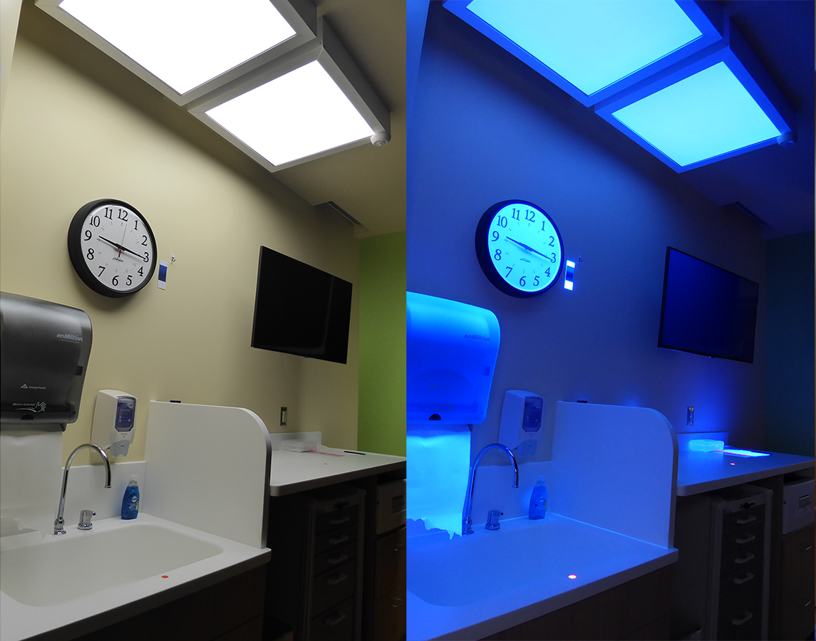

LRC researchers tested a hybrid lighting system, developed by GE Current, which was designed to provide both visible white light and disinfecting UV-A. The system was retrofitted into a modern hospital newborn intensive care unit (NICU) at Memorial Beacon Children’s Hospital in South Bend, Ind. The UV-A dosing was set to levels calculated safe for human occupation. Eight-hour exposures on counter surfaces were effective for suppressing pathogens identified by the CDC as highly problematic for health care facilities. LRC researchers also conducted a survey aimed at assessing the opinions of professional staff working in the NICU about the hybrid lighting system. Staff members accepted the hybrid lighting system, and the comments about the system were generally positive. An analysis of photodegrading effects suggested that UV-A resistant equipment and furnishing may need to be installed with this technology. The findings were recently published in Lighting Research & Technology.
