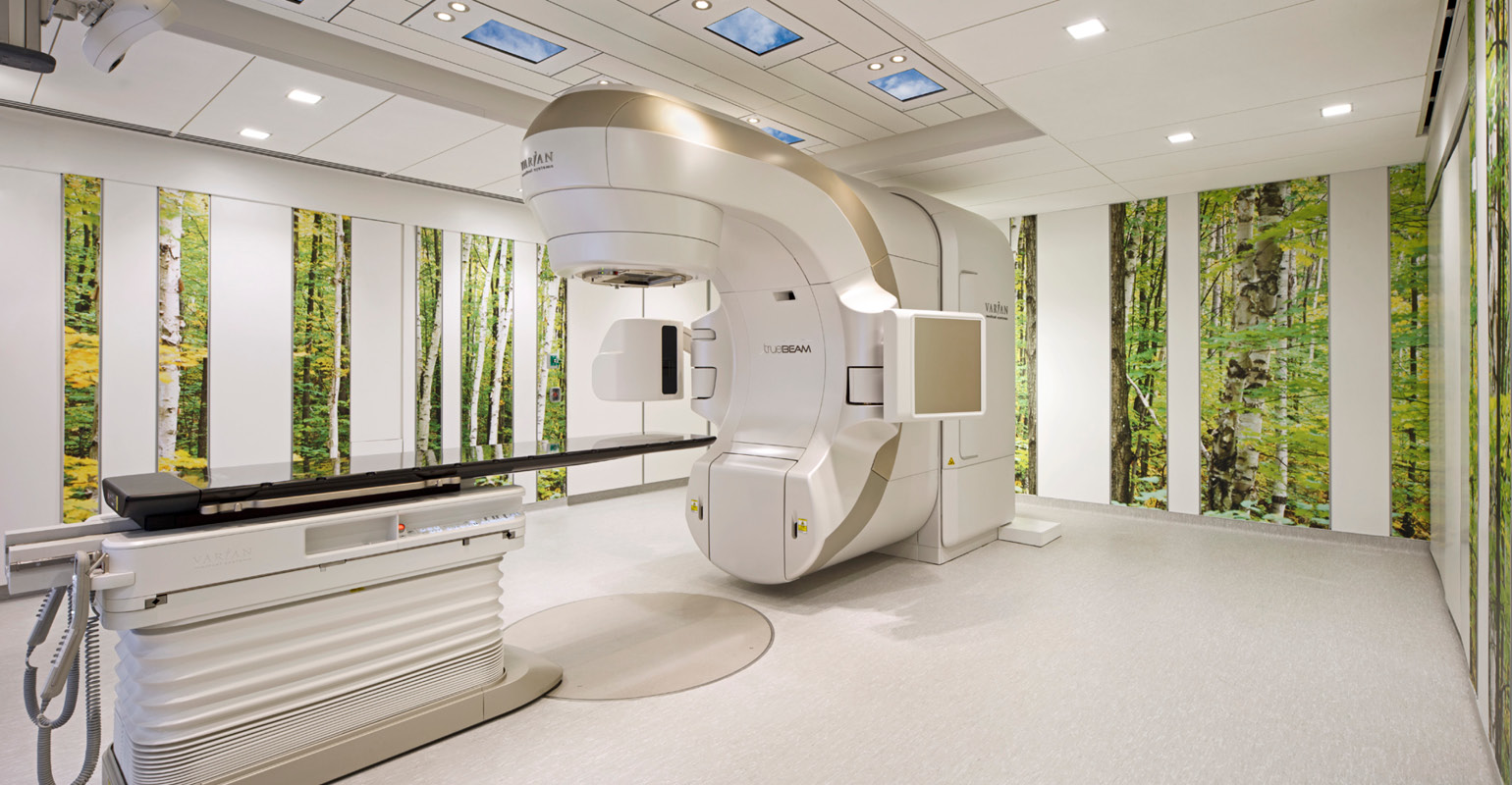

The diagnostic and treatment areas section had a major face-lift in this update, with abundant photography to help designers visualize medical equipment and calming light strategies often used in imaging suites (Photo 2). Part 2 wraps up with patient support facilities, including clinical laboratories and pharmacy services.
