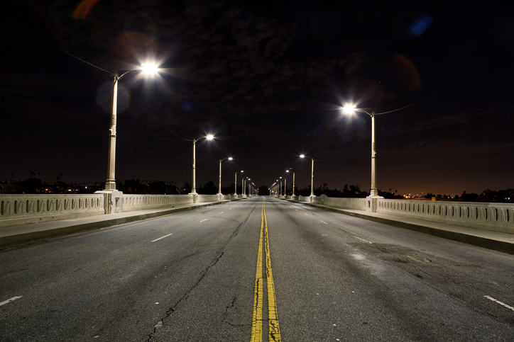

Roadway lighting, 6th St Bridge, Los Angeles
