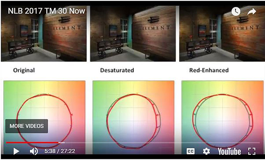

A major point of discussion in the video is the complexity of TM-30’s two-part color characterization and the confusion it might cause for lighting customers.

A major point of discussion in the video is the complexity of TM-30’s two-part color characterization and the confusion it might cause for lighting customers. Burkett said he makes extensive use of TM-30 and lighting mockups to show clients how light sources with the same CRI can produce dramatically different visual effects because of variations in gamut. But, said Burkett, using TM-30 still requires considerable education, not only for clients but for others in the lighting industry.
