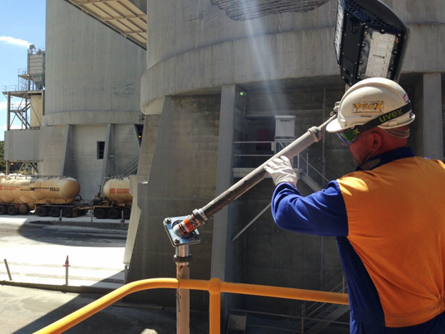

Number three on the list requires some ingenuity and thought. Installation and servicing of lighting for grade level may require the use of a ladder or scaffolding. The electrician must tie off when working over certain heights. These heights are dictated by OSHA 29 CFR 1926; however, the plant may have more stringent requirements. When the luminaires are installed on elevated platforms and walkways, consideration should be given to outfitting the stanchion mounted luminaires with break-over type conduit stanchions or other variations of such so that the luminaire can be lowered and accessed without having to climb a ladder and then subsequently not having anywhere to tie off.  Likewise, for surface-mounted luminaires or column-mounted luminaires at elevated heights, they should ideally be placed near a structural member so that 100% tie off can be achieved while installing or performing maintenance.
