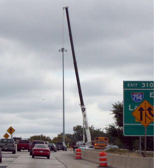

Guidelines for installation, maintenance, and testing of stadium and athletic field lighting can take yet another page from the high-mast lighting handbook. The U.S. Department of Transportation's (DOT) Federal Highway Administration publishes “Guidelines for the Installation, Inspection, Maintenance and Repair of Structural Supports for Highway Signs, Luminaires, and Traffic Signals,” which includes sections on high-mast lighting poles. In addition, many state DOTs maintain their own guidelines and regulations.
These publications emphasize the structural as well as the electrical component of installation and maintenance of the high-mast poles. “The first step is to recognize that a high-mast light tower is not a big light pole,” says Charles N. Landey, P.E., staff member of the electrical operations division of the Wisconsin DOT, Southeast Region, Waukesha, Wis. “It is a structure.”
The foundation design and anchor rod specification must be signed by a registered professional engineer licensed in the site's state who is also familiar with local soils, according to Landey. “If the engineer suggests a soil drilling and analysis, don't cheap out,” Landey advises.
Therefore, Landey leaves the design, maintenance, and inspection of the 77 high-mast light structures under his jurisdiction to structural engineers and independent nondestructive testing facilities. “I should think that by now every state DOT knows this, especially all that liaise with the Federal Highway Administration,” Landey explains. “The people who may not know what to do are truckstop owners, railroads, prison systems, and port authorities, who may sub everything out to an electrical contractor that doesn't have experience with these structures.”
Nondestructive testing is a wide group of analysis techniques used in science and industry to evaluate the properties of a material, component, or system without causing damage. Common nondestructive testing methods include ultrasonic, magnetic particle, and radiographic, which do not permanently alter the pole being inspected.
Schools contracting out stadium light pole installation may not be familiar with installation requirements and the fact that the owner should have installation inspection. They often bid the job to an electrical contractor that may be more focused on the electrical component over the poles' structural requirements. “The state governments follows state and federal requirements, and also have their own requirements and people on-site who monitor and document the installation to verify the installation was done to specification,” says Todd Sabo, certified welding inspector and level II NDT technician with TUV Reinland/Non-Destructive Testing Services (NDTS), Grand Rapids, Mich. “In my experience, the electrical contractor gets the job and installs the light poles in accordance with procedures and requirements from the manufacturer, but they don't have any control over how they were inspected and documented.”
In fact, Landey often witnesses the concrete pour for the installation of a new high-mast pole. “I almost always inspect the pour of a high-mast light tower foundation from the beginning to end of the pour — or at least the first two or three units on a given project,” says Landey. “What I am looking for is that each anchor rod must be absolutely plumb. Anchor rods will shift position during the pour.”
Moreover, contractors may be tempted to make changes to the plans during installation. These changes could possibly cause structural flaws in the poles. “The contractor should have the drawings and requirements to make sure the poles are installed properly,” says Bob Bills, CEO of NDTS. “But they sometimes make an alteration without running it by an engineering firm or the manufacturer, and that can create an issue in the future. Most of the errors we find are from improper installation. If they're not installed properly, you're reducing your safety factor right there.”
Landey refers to the documentation of installation as the “inventory system,” which is a written record of all changes to design or installation specifications. “We do that so the owner always will know what was built when, to what specification, and how or if it was modified,” Landey explains. “I capture in writing any deviation from project specifications and save everything. I make sure a number of staffers know where to look for the information for as long a period of time as the structure is in existence.”

Structures for both high-mast and stadium lighting can remain safely in place for up to 30 years. “As a rule of thumb in the highway department, you're building for 30 years at least,” says Landey, noting that in his 20-year tenure with the department, there has never been a structure collapse.
To extend longevity while maintaining safety, the Wisconsin DOT keeps to a strict maintenance and testing schedule. It schedules regular inspections by qualified structural engineers and also performs visual inspections of the towers himself as a supplement to professional structural inspection. “I always find out more by looking than by sitting in the office,” explains Landey, who schedules his visits on days with good visibility but not blinding sunshine. He also brings along a notebook and low-powered binoculars but no camera. “Personally, I'm not big on cameras, because if there is an issue significant enough that it needs a photograph, I'm going to call in the professionals,” he explains.
Each time Landey goes out, he familiarizes himself with the notes from his last inspections as well as the documents from the professional testing facility. He then writes down any visible changes to the pole. Anomalies with newer poles are cause to contact the manufacturer.
Still, not all structural flaws are visible to the eye. NDTS uses certified technicians, such as a certified welding inspector from the American Welding Society (AWS) or level II technicians from the American Society for Nondestructive Testing (ASNT). “The procedure we use is something that we partially developed from the Michigan DOT and the Federal Highway Department, based on the many years of studies done on the reasons for failure of sign structures and luminaires,” says Bills.
The technicians check the general condition of the structure and the coating for corrosion. They also visually examine the transverse welds with high-power binoculars and check the tower for leaning. The critical part of the inspection is to check the base plate connections of the anchor bolts to the structure into the foundation, Bills notes.
Then, the technicians visually inspect the concrete and the anchor bolt hardware (washers, nuts, and thread condition), holding the base plate of the pole down to the concrete foundation. The latter test is performed with a wrench and a ball-peen hammer to sound out if the nuts are not tight. Next, the technicians delve deeper. They proceed with a liquid penetrant and/or magnetic particle test on the baseplate weld to the upright of the pole and an ultrasonic test down the length of each anchor bolt to just below the concrete surface (normally 10 in.) to verify the anchor bolts were not strained during the erection process. If the anchor bolt was overly strained, a crack could have occurred at the thread, resulting in an unfavorable outcome for the structure. “Most of the failures occur at the base of the structure,” he says. “With the record of failures, not only with the Whitco poles, but also with many other structures that we've seen at failure investigations, there should be a regularly scheduled maintenance and testing program, especially for older structures.”
In the Wisconsin state highway system, structures with apparent problems are immediately replaced or, if it can wait, scheduled for replacement as the budget allows. Landey has removed two structures through emergency procedures and replaced several others in a planned manner. “If there is any doubt about the shaft, I take it down,” says Landey. “You need not demolish a structure for a spot of rust, and small cracks can be repaired by qualified personnel. However, those fixes are for newer structures with a complete file on hand.”
Unfortunately, some electrical maintenance crews only attend to the pole every three to five years or when at least six of the 12 lights atop the pole burn out, a practice that's insufficient for detecting potentially significant flaws. “Poles should be included in a regular maintenance schedule like any other equipment in a facility,” Cornett says.
Landey advises a two-year schedule. “Go out a year after they're put up, and then on the third, fifth, seventh year, etc.” In Wisconsin, professional testing is performed on a two-year schedule. “They go out if I see something that doesn't look right,” Landey says. “They don't work for free, but it's a necessity.”
