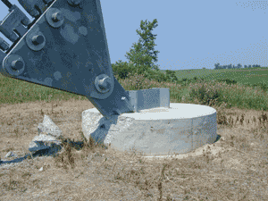

The first strike caused minor structural damage. The second, however, delivered a much more concentrated blow, causing severe damage to two of the massive reinforced-concrete anchors, which secured the cables keeping the tower upright. The anchors extend between 40ft and 52 ft underground. Concerns over the tower collapsing, which would take the station off the air for several months while it was being repaired, led to an upgrade of the entire facility's grounding and lightning protection system.

“Based on the location and nature of the damage, along with what we saw in the tower’s construction plans and what we found in the field, we strongly suspected that the culprit here was an inadequate grounding system,” says Conroy.
