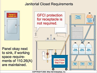

Is GFCI protection required for a 15A or 20A, 125V receptacle that is located within 6 feet of a janitorial closet sink in a commercial building?
All questions and answers are based on the 2005 NEC.
Q. Is GFCI protection required for a 15A or 20A, 125V receptacle that is located within 6 feet of a janitorial closet sink in a commercial building?
A. No. However, GFCI protection is required for all 15A and 20A, 125V receptacles located within 6 feet of a dwelling unit utility sink [210.8(A)(7)]. (Figure)
