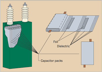

Power capacitors are made up of capacitor packs. The individual packs are stacked together and jumpered to form parallel or series units. Each pack comprises metallic plates, often made of aluminum foil, separated by a polypropylene dielectric. Paper is sometimes also used as a dielectric. These foil/polypropylene sandwiches are rolled up and enclosed in an oil-filled tank. Capacitors like this are commonly used for power factor correction and filtering on systems ranging from low-voltage through the highest transmission voltages.
