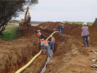

Underground conduit pathways. Underground conduit construction may be your best option when a new overhead pole line installation isn't practical, an existing pole line can't support additional cable placements, or an area is too congested to allow for a direct-buried installation.
A primary objective of conduit system design is to make your conduit section lengths as long and straight as possible, with a minimum number of horizontal and vertical directional changes (see photo above). This reduces the number of maintenance holes (MHs), hand holes (HHs), cable splices, and associated cable setups required during the cable-pulling stage of the project. Installing underground conduit so a slope exists at all points of the run allows drainage and prevents the accumulation of water. A drain slope of no less than 1% grade toward the MH is desirable.
Conduit that breaks away from the main duct run and connects to structures such as buildings, pedestals, cabinets, or poles is known as branch conduit, of which there are two types: lateral and subsidiary. Lateral ducts typically run from the sidewall of an MH to the structure. Subsidiary ducts extend from the end wall of an MH, run along the main conduit run for some distance, and then turn to feed a structure (See Fig. 1 above).
If constructed at the same time as the main conduit run, subsidiary ducts should be placed on top of the main run; this is the most economical means of placement. It also affords some top protection for the main run duct bank. However, make sure these individual ducts enter the sidewall corner of the MH. Note, however, that this placement reduces racking space in the MH. When this duct is part of a multiple-duct structure, you should design the upper tiers of the structure (preferably the corner ducts) for subsidiary use because they are more readily accessible. Generally, 2-, 3-, or 4-wide arrangements are preferred for single- or double-wall racking.
The advantages of constructing formations using individual conduit is that the material is lightweight; provides good joint integrity; produces a strong, stable structure if concrete-encased; can be easily rearranged to avoid obstacles; can be pneumatically rodded; and is available with bell ends to allow ease of joint connection. In some situations, you may find it more advantageous to use multiple-bore conduit because it doesn't require long trench openings, select backfill, or ready-mix concrete.
In some special applications, you may need to place conduit in large steel tubes (casings) to protect it or to facilitate a crossing where an open trench cannot be provided. This may occur at railroads, major state highways or freeways, or at river or stream crossings. After the conduit installation is complete, you must fill the casings with fine sand (blown in under air pressure) and seal both ends with a 3-in. concrete wall.

Direct-buried pathways. If you don't have access to a pre-existing tunnel, you can install the cable directly in the ground and forgo the added time and expense of designing and constructing a conduit infrastructure. A direct-buried installation offers many benefits over an underground conduit system installation, but it does have its drawbacks, the most obvious being the chance for accidental dig ups. When crossing under roads, railroads, and waterways, you should place the cable inside either a metal or rigid plastic duct for added protection.
At a minimum, the NESC requires you to place direct-buried cable 24 in. below finished grade. However, when installing optical fiber cable it's generally recommended that you place the cable at a minimum depth of 3 ft below grade. The added depth takes into account the added circuit — carrying capabilities of the optical fiber cable. In areas of the country where the ground freezes, you should place the cable below the frost line because frost uplift can damage cables.
