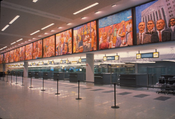

The Arrivals Hall uses remote-ballasted, 70W and 150W double-ended MH lamps within semi-recessed fixtures. Serving as wall washers, these fixtures illuminate large sculpted panels mounted above the long counter.
Within the customs/immigration area, 32W T8 fluorescent lamps provide general illumination over the INS counters. Custom-made, 8-ft wide frames support the two linear runs of lamps, which are served by ballasts mounted within a central extruded aluminum channel. As the electrical contractor on the project, E-J Electric Installation Co., Long Island City, N.Y., had to coordinate the installation of the custom junction box at the apex of the assembly.
