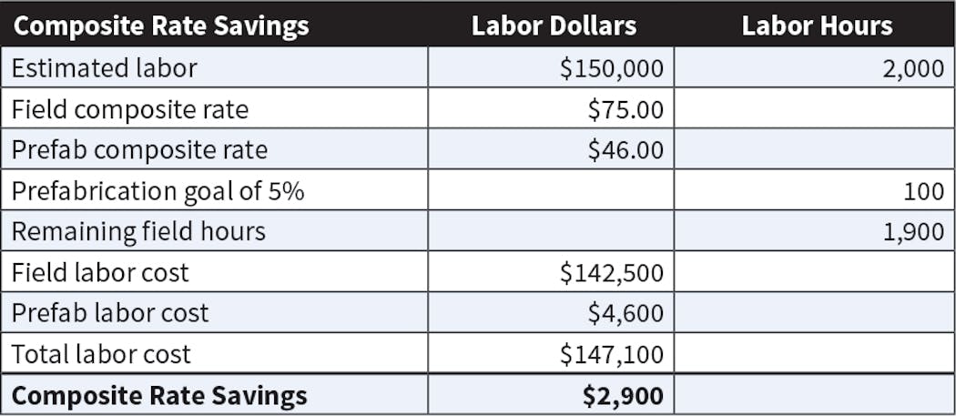

The second aspect of the cost savings metric of prefabrication to examine is its impact on the project’s composite labor rate. Assume that field labor for the company carries a fully loaded rate of $75 an hour, while the prefabrication department maintains a labor rate of $46 an hour. From the labor budget of 2,000 hours, the Mission Critical project has an estimated labor cost of $150,000. Using the project manager’s prefabrication goal of 5% or 100 hours from the labor budget, the project now has 1,900 field hours at $75 an hour or $142,500 in field labor. The prefabrication department’s labor budget of 100 hours at $46 an hour costs $4,600. The total labor budget on the project is now $147,100 or a savings of $2,900 from the original estimate of $150,000. In doing so, the project manager is able to spend $147,100 on labor and still maintain the original labor budget of 2,000 hours. This is because the composite labor rate on the project has been reduced by $1.45 or 1.9% to $73.55 (Table 2).
At the end of the day, because the project manager set a goal of 5% prefabrication on project Mission Critical, he was able to achieve a total cost savings of $5,075 by saving $2,175 based on the 1% increase in the effective labor productivity, and a savings of $2,900 on the 1.9% reduction of the composite rate.
