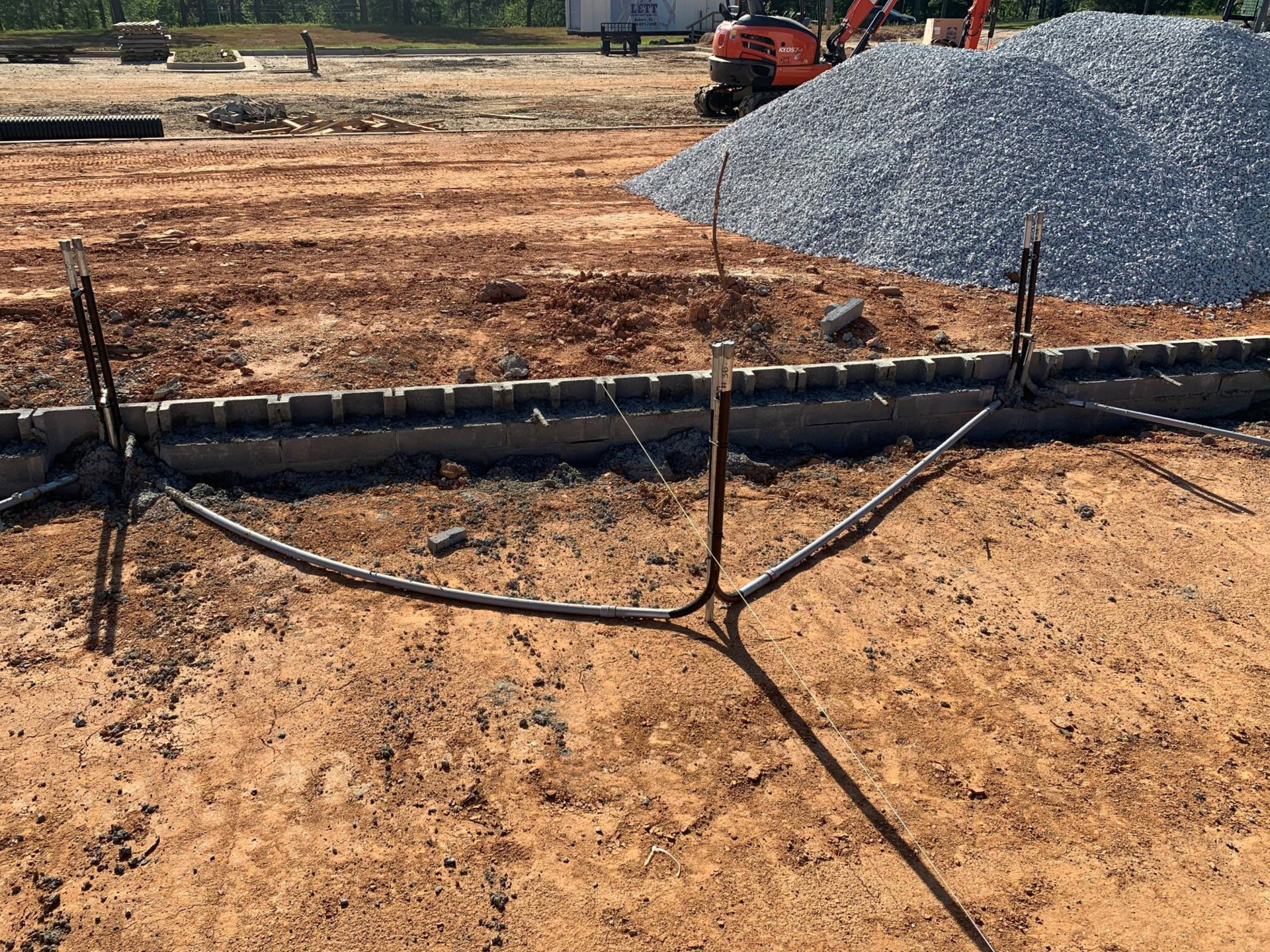

Photo 1. These bends had incorrect lengths and required manipulation on the job site.

Incorrect dimensions
Specify dimensions when requesting prefab to avoid the potential need for manipulation on site. As shown in Photo 1, this crew had to re-orchestrate conduit runs and cut into concrete blocks to fit bends that were made at the shop.

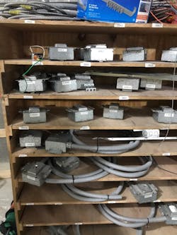

An example of difficulties in moving materials around a job site is shown in Photo 3. The conduit stubs, although they saved installation time, posed some handling challenges.
Entry between floors wasn’t wide enough, so they had to be removed from the cart, brought in, and placed back on the rack. Then, they were rolled to the necessary location. Due to how they were stacked, the crew also struggled to remove one item at a time from the rack.
