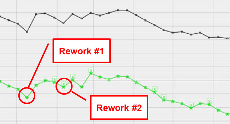

Fig. 1. Identification of rework using ASTM Standard E2691 with job productivity assurance and control.
For instance, Fig. 1 shows the productivity differential trend of a job and its “conduit” cost code (which happens to represent 48% of the work on the job). There are three points where rework was made visible through the E2691 method, by capturing project notes during the weekly review of the job productivity assurance and control (JPAC®) and short interval scheduling (SIS®) results:
• Rework #1: “Some rework on some coils and main rack in auditorium had to be lowered (was missed in the drawings and had to make room for mechanical).”
• Rework #2: Changes added for BIM rework.
• Rework #3: “Rework for 150 seat conduit, fire alarm conduit and communication duct.”
As mentioned above, anomalies in productivity are made visible anytime hours are charged to the conduit cost code, but there is nothing in the WBS for the field to observe percentage of completion of work toward final completion. The cause for this could be change orders, contracted scope that was missed in the WBS, or because the foreman on a large job is not getting to every nook and cranny to see the work.
In the case of Fig. 1, as part of the review process in E2691, “rework” was identified by the foreman, and a note was made to capture it. The labor does not get chastised; rather, the field supervisor and/or PM work with the labor to understand the root cause. In the case of Rework #3, the SIS results for the same time frame (week ending July 25, 2015) show a reason code of “worker error,” causing 9 hours not worked as scheduled (Fig. 2). The detail listed behind the reason code states “Floor box conduit missed during initial rough in. [Electrician] piped the power/data feeds into floor box.” So, by using both the special cause and common cause analysis methods of the E2691 standard, the rework is made visible without any extra need for tracking and measurement, and can be quantified, which is explained next.
