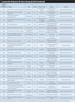

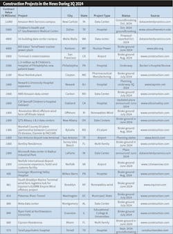

No. 3 — Mega-projects of $1 billion or more in total construction value will continue to grab headlines.
When you consider that electrical work typically accounts for 10% of the total value of a large non-residential construction contract, you can see why landing work at one of the many mega-projects valued at a billion dollars or more is such a big deal. Table 1 and Table 2 list 50 of the largest projects in the pipeline or underway, including 16 mega-projects with a contract value of $1 billion or more. Data centers, EV plants, utility-scale renewable projects, hospitals, and airports were among these mega-projects.

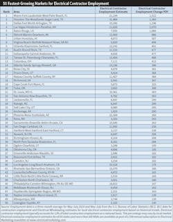

No. 4 — A handful of local markets and states will continue to see the lion’s share of business.
While it’s always important to look at national construction data or economic indicators as a baseline, the disparity in the growth rates of individual states or local market areas should always be considered, as should the consolidated nature of the electrical construction market. For example, according to ConstructConnect’s “August 2024 Starts Forecast” published in 2024, 10 states accounted for 55% of the United States total of $953.6 billion in total construction spending — Texas, California, Florida, New York, North Carolina, Georgia, Arizona, Ohio, Virginia, and Tennessee. Building permits also show that same consolidation, as 10 states accounted for 45% of all single-family building permits year-to-date through August 2024.
Consolidation is often the case with local markets, too, where a single metropolitan statistical area (MSA) can account for a tremendous amount of building activity or electrical contractor employment in an individual state.
Two of the most dramatic examples are the Phoenix and Las Vegas metros. For example, the Phoenix-Mesa-Chandler, Ariz., MSA accounted for 72% of all of Arizona’s single-family building permits year-to-date through August 2024, and the Las Vegas-Henderson-North Las Vegas, Nev., MSA accounted for 80% of single-family building permits in Nevada year-to-date through that same period.
When you look at electrical contractor employment in these two markets, the same trend is apparent. According to the most recent construction employment data from the U.S. Census Bureau and estimates from Electrical Wholesaling, the Phoenix metro accounts for 79% of all electrical contractors in Arizona while the Las Vegas metro accounts for 71% of electrical contractor employment in Nevada (Table 3).

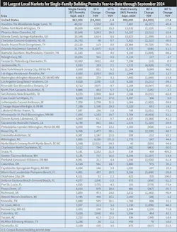

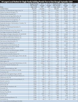

No. 5 — Electrical contractors may start to see more single-family construction work if mortgage rates decline.
While the decline in single-family home construction can be linked to a lack of available lots, permitting red tape, and broad demographic declines in the key first-time homebuyer age group of 25- to 33-years-old, comparatively high mortgage rates have probably wreaked the most havoc on the homebuilding industry over the past few years. Robert Dietz, chief economist for the National Association of Home Builders (NAHB), said in the association’s September building date report, “While single-family home building increased in September, higher mortgage interest rates in October are likely to place a damper on growth in next month’s data. Nonetheless, NAHB is forecasting a gradual, if uneven, decline for mortgage rates in the coming quarters, with corresponding increases for single-family construction,” as shown in Fig. 3 and Table 4.
