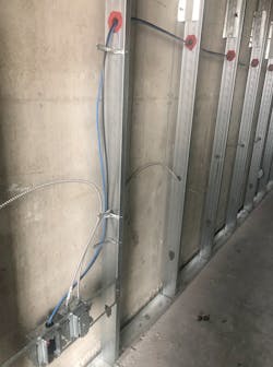

Overbuilding
If you’re still able to walk the job and see exposed rough-in, look at what was required for the installation compared to what was done. Do you see any of the following:
  • Unnecessary bends
  • Unnecessary conduit routing
  • Use of additional boxes or junctions boxes
  • Unnecessary supports
  • If you do both electrical and technology work, rough-in work being done for multiple systems (e.g., branch wire for power and low-voltage cabling) in the same space
  • Oversized conduit for the application
  • Unnecessary (and more expensive) materials used than what is specified (e.g., installing EMT when the spec permitted MC cable)
  • Work being performed that is not part of the scope — either knowingly helping other trades or not understanding the details of the contract (see Photo 1 below)
Recognizing overbuilding before it occurs is difficult and requires planning by someone who has experience that includes various means and methods. Even though branch circuit work is physically “small,” the decisions made at the layout phase can reduce overbuilding by understanding the specs and requirements, which are often not part of the newer electrician’s experience.

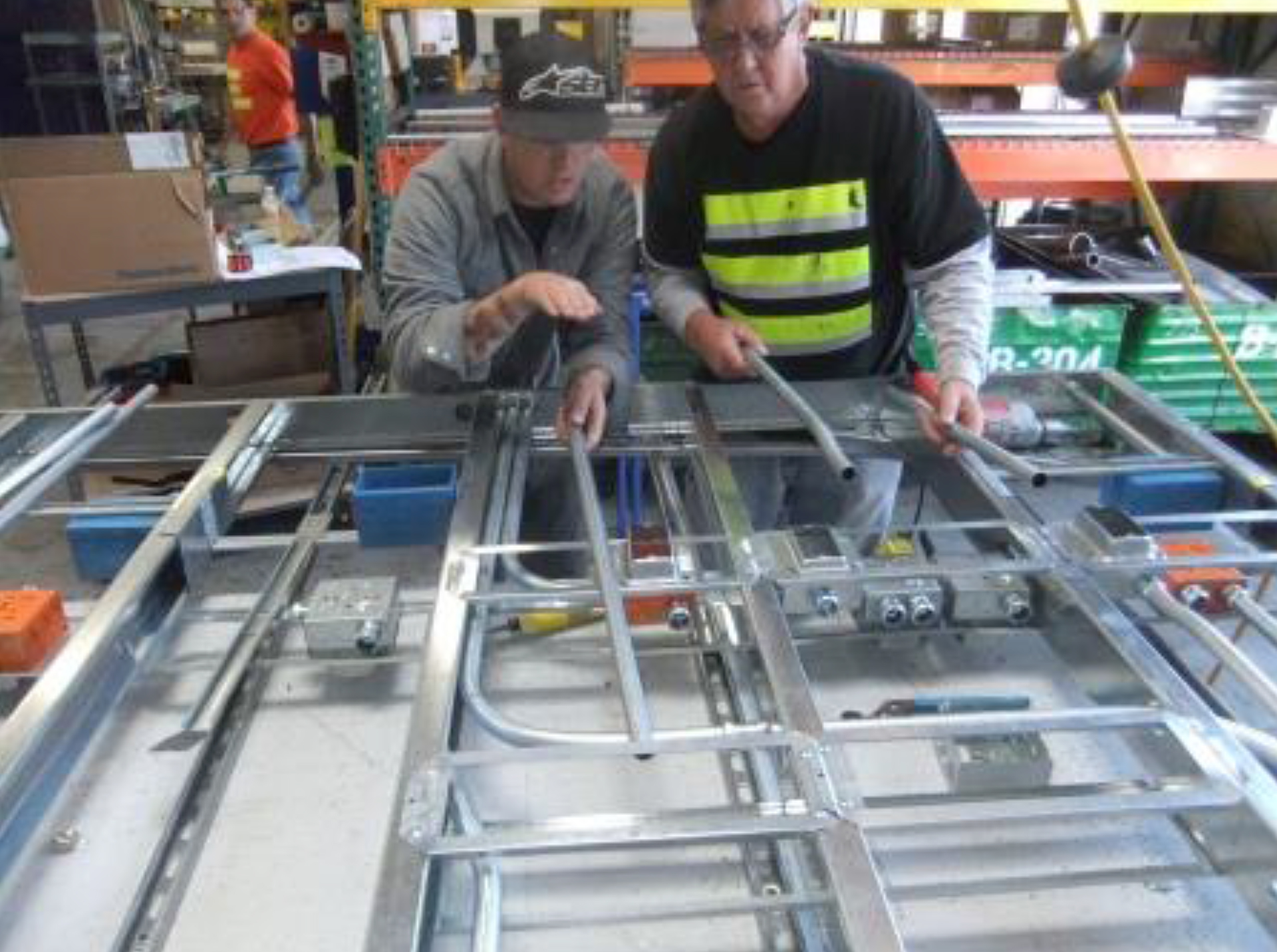

Missed prefab opportunities
Prefab planning requires prefab thinking, which results from prior experience with prefabricated assemblies and their installation (see Photo 2 below). The branch circuit lends itself well to prefabrication; however, this needs to be brought to the lesser-experienced worker by management and supervision. Prefab thinking starts with leadership and is best translated through training and reference materials, such as the checklist below for identifying branch opportunities.
  • Kitting by location (both components and hardware)
  • Labeling by kit and location
  • Color-coding to reduce identification errors
  • Assembly and component labeling to reduce installation errors
  • Tools as needed for installation on location with the kits
  • Common boxes, knockouts, and mounting brackets
  • Pre-attached connectors and ground terminals
  • Common mud rings
  • Pigtailed devices and common connectors
  • Offsets and 90s (pre-shaped) and cut to length
  • Racks, trays, and trapeze assemblies
  • Multiple conduits pre-mounted on common rack assemblies
  • Pre-configured and pre-tested programmable devices
  • Returns and clean off containers
  • VMI to include delivery and material movement

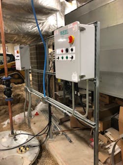

One of the biggest cost events associated with weak or inexperienced planners is rework or extra work (see Photo 3 below). Running wires around other trades or where they need to be redone is prevalent with inexperienced planners. Not taking the time to fully visualize the completed project will lead to incomplete or ineffective coordination. Missing early coordination opportunities is a common root cause of poor layout, especially on BIM-coordinated projects.
