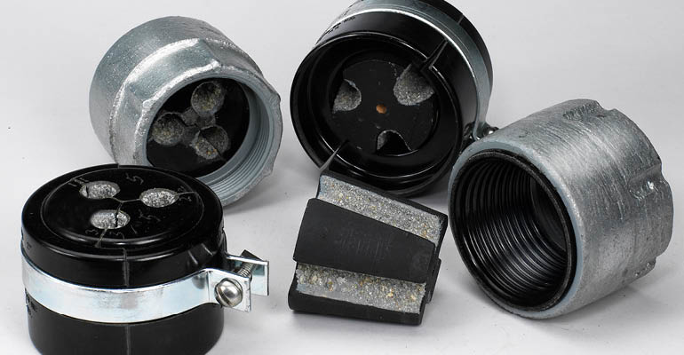

Cable support design is deceptively simple: Essentially, bushings go over the opening of the conduit in which non-armored cables pass through. Since the shape of the bushing is like a wedge, the weight of the wires tightens the bushing around them. The wedge exerts uniform pressure around the cable, providing holding force of that required by code without deforming the cable insulation.
There are two basic types of cable supports: the one-piece plug and the multiple segment plug. The one-piece has a single wedging plug with a groove for each wire. It is ideal for all types of non-armored cables 600V or less, plus it is considered the easiest to install. In contrast, the multiple segment version has a wedging plug constructed so that each cable is supported between grooves in adjacent segments. This uniform pressure distribution is required by the softer types of insulations frequently used at higher voltages. Some supports line cable grooves with coarse grain grit to improve holding power. This grit won’t damage the jacket or insulation on the cable. In both cases, either single or multiple segment, it is good practice to space conduits about ½ in. or further than normal to accommodate the cable support body.

Vertical runs of “no-lube” cables introduce another wrinkle, one that requires a bit of knowledge of coefficients of friction. Here is the problem: No-lube jackets are slippery. Because of this, a wedging plug featuring grooves lined with a coarse grain grit is recommended. This grit improves the cable support holding power and does not damage the jacket or insulation on the cable.

Since the split body of a retrofit-style support rests on an existing bushing atop the conduit raceway, it is possible to use it where cables are already installed. The two halves of the body are placed around the cables, seated on the existing bushing, and securely held together by the steel band set in a groove around the body. The plug is then wedged between the cables, and the job is done.
