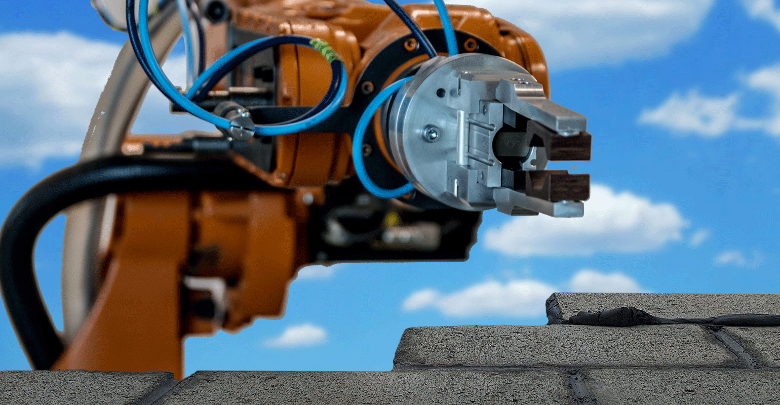

Robots that do the work of an electrician on an actual job site? Flying drones that check on a project’s progress? Robots that lay bricks (see Photo). Is this for real? Technology is finally creating disruption in the construction arena. But how can this robot fantasy match up with today’s reality? This article provides a practical overview of what modeling and simulation may bring to electrical construction in the near future as well as presents a few examples of what is already in place on the robotics front.
