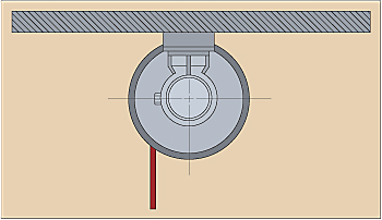

  • Vertical lift applications call for a reel mounted on the ceiling, wall, or overhead structure where the entire cable length is vertically suspended. Spring tension must be capable of lifting and rewinding the fully extended cable (Fig. 1).
