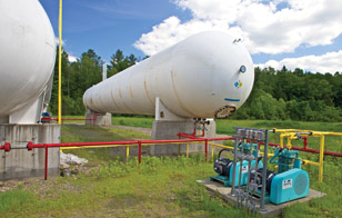

For example, acetylene, which is widely used in chemical processes, is easily ignited and considered a Group A material. Hydrogen is an example of a Group B gas, ethylene is Group C, and propane (see Photo 1) is Group D - all of which fall within Class I. The 2011 NEC Handbook contains an extensive multi-page list of hazardous materials with group designation and other properties, as part of its commentary, but the requirements don’t end there.
