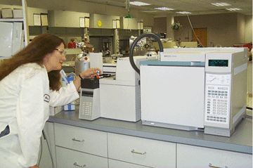

The flammability of headspace gases makes it important to follow precautions when extracting, storing, transporting, and testing fluid samples. Although it’s possible to test samples on your own (portable combustible gas detectors are available for field use), the dangers the procedure presents make it a risky proposition. Sending samples to qualified material testing laboratories is the safest option (Photo 1). Transformer design, manufacturing, and operational variables will affect acceptable gas levels, generation rates, concentrations, and the time it takes for the gases to distribute evenly throughout the unit. Once the lab determines the types of gases and their quantities, the next (and perhaps most difficult) step is determining whether their concentration is high enough to cause significant problems.

Photo Courtesy of the Thomas A. Edison Technical Center - Cooper Power Systems - Franksville, WI
