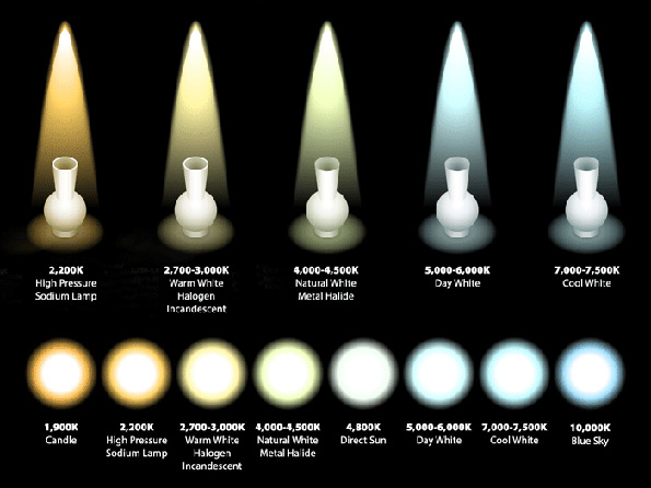

Mahoney then walks the reader through a very clear description of the way understanding color temperature and correlated color temperature (CCT) can help buyers make better decisions. Such understanding can also help contractors and designers better convey to their customers the quality of light delivered by a source. She also offers a nifty graphic illustrating the ranges of color temperatures (a teaser is shown at right).
"Candlelight ranges from 1,500–2,000K, and to most people it is romantic-feeling. Thus restaurants, hotels, and homeowners who want a cozy feel may want to look toward color temperatures that are 2,400–2,700K. Transitional spaces moving from cozy to a more productive space (like hallways) may opt for color temperatures in the 3,000–3,500K range."
