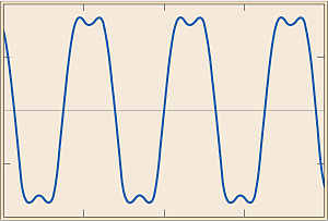

If you connect an oscilloscope to a 120V receptacle, the image on the screen usually isn't a perfect sine wave. It may be very close, but it will likely be different in one of several ways. It might be slightly flattened or dimpled as the magnitude approaches its positive and negative maximum values (Fig. 1). Or perhaps the sine wave is narrowed near the extreme values, giving the waveform a peaky appearance (Fig. 2 below). More than likely, random deviations from the perfect sinusoid occur at specific locations on the sine wave during every cycle (Fig. 3 below).
The flattened and dimpled sinusoid in Fig. 1 has the mathematical equation, y=sin (x)+0.25 sin (3x). This means a 60-Hz sinusoid (the fundamental frequency) added to a second sinusoid with a frequency three times greater than the fundamental (180 Hz) and an amplitude ¼ (0.25 times) of the fundamental frequency produces a waveform similar to the first part of Fig. 1. The 180-Hz sinusoid is called the third harmonic, since its frequency is three times that of the fundamental frequency.

Analyzing harmonics. When the magnitudes and orders of harmonics are known, reconstructing the distorted waveform is simple. Adding the harmonics together, point by point, produces the distorted waveform. The waveform in Fig. 1 is synthesized in Fig. 4 by adding the magnitudes of the two components, the fundamental frequency (red waveform) and the third harmonic (blue waveform), for each value of x, which results in the green waveform.
