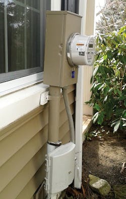

Frame Job
This gem was sent in by Tom Useller of Useller Electric LLC in Newton, Pa. In his words, “I took this picture at a house I was working at the other day. Thought you would get a kick out of it. What were they thinking? Feel free to share. Thanks, Tom.”
Perhaps the installer thought this would go unnoticed. Section 110.13(A) requires electrical equipment to be “firmly secured to the surface on which it is mounted.” In this case, the meter enclosure is mounted to nothing but air. How are we supposed to secure an enclosure to air? I certainly wouldn’t consider this “neat and workmanlike” either, as required by Sec. 110.12. The communication equipment and wiring that is attached to the raceway is another problem. According to Sec. 800.133(B), “communications wires and cables shall not be strapped, taped, or attached by any means to the exterior of any raceway as a means of support.” The unsupported service cable leaving the meter enclosure needs to be secured within 12 in. of the enclosure in accordance with Sec. 230.51(A).
