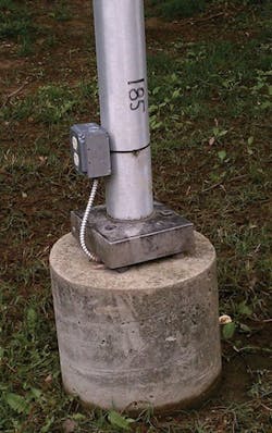

This Won’t Weather the Storm
Apparently, this installer had no concerns about the effects the weather could have on this installation. It looks as if none of the equipment used for this receptacle installation is rated to be used in this wet location.
Section 406.9(B) requires 15A or 20A receptacles in wet locations to be installed in an enclosure that is weatherproof, whether or not a cord-cap is plugged into it. Where 125V receptacles are installed in wet locations, they must be listed as weather-resistant (WR) type receptacles. Boxes installed in wet locations must be listed for use in these locations as required by Sec. 314.15. Neither this box nor its cover is made for this wet location. As shown in the other Illustrated Catastrophes photo (above), moisture can destroy receptacles if they are not properly protected.
Another problem I notice is the wiring method used to supply this receptacle. MC cable used in wet locations must include a corrosion-resistant jacket over the metallic covering as specified in Sec. 330.10(A)(11).
Lastly, I question the supporting means for this box. I’m not so sure those black cable ties will provide rigid and secure support as required by Sec. 314.23(A).
