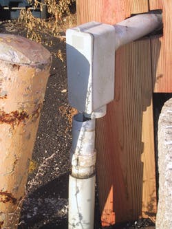

    COMING UNGLUED
    From the looks of the joint between the piece of rigid nonmetallic conduit (RNC) and the coupling at the expansion fitting, it looks like the installer forgot to use glue. All joints between lengths of RNC, and between conduit and couplings, fittings, and boxes, must be made by an approved method (352.48). Where direct-buried conductors, raceways, or cables are subject to movement by settlement or frost, they must be arranged to prevent damage to the enclosed conductors or to equipment connected to the raceways. This can be accomplished by installing “S” loops in underground direct burial to raceway transitions, using expansion fittings in raceway risers to fixed equipment, or installing flexible connections to equipment [300.5(J)].
