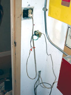

Zip-a-Dee-Doo-Dah
The installer who used “zip cord” to wire this transformer created several violations. The way in which this was installed leaves the transformer case ungrounded and the splices floating in free space. The use of flexible cord in this manner creates a violation of 400.7 and 400.8. There are 10 permitted uses for flexible cords described in 400.7 including, in part, wiring for pendants, luminaires, portable signs and appliances, elevators, cranes, for the prevention of noise or vibration, specific appliances, moving parts, and elsewhere specifically permitted by the Code. Wiring this transformer was not on this approved list. In addition, 400.8(1) prohibits using flexible cord as a substitute for fixed wiring methods. The lack of equipment grounding or bonding for the transformer case creates several violations of Art. 250, including 250.4(A)(2)and (3), which generally require the case to be grounded and bonded. Similarly, 250.110 requires equipment grounding for the non-current-carrying metal parts of fixed equipment likely to become energized. You may also notice the missing cover for the device box. This is a violation of 404.9(A) and 406.6, which require faceplates to be installed for switches and receptacles. All in all, this installation creates some serious shock hazards.
