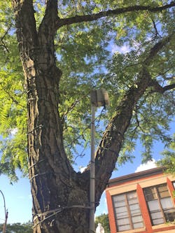

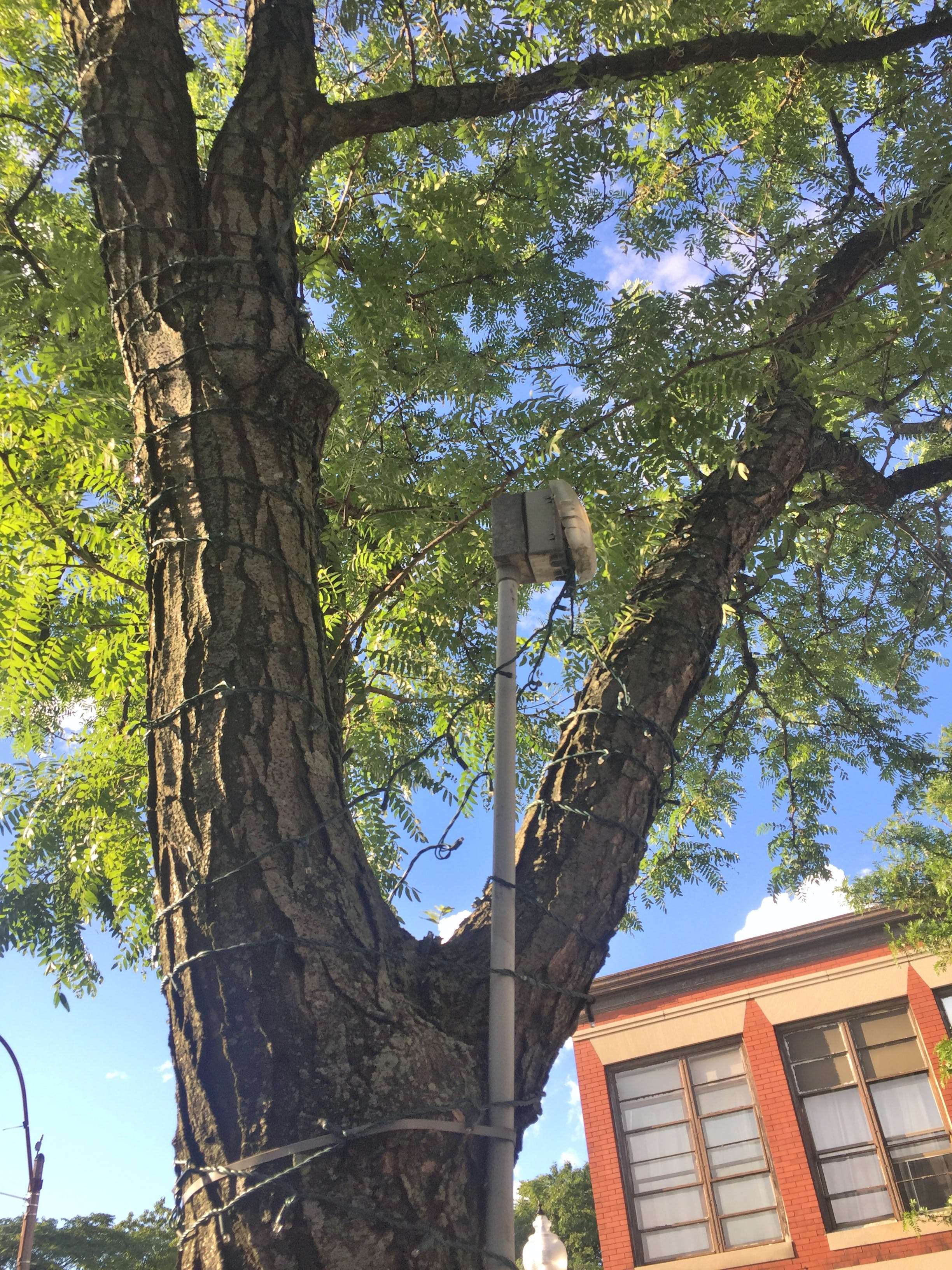

A Permanent Temporary Installation
Slapping a box on the end of rigid PVC conduit is no way to properly support and secure a box. This method is not one of the methods specified in Sec. 314.23(A) through (H) and is prohibited by Sec. 352.12(B). Section 314.23(E) and (F) both permit raceway-supported enclosures. However, in both cases, the enclosure must have threaded entries or hubs, and conduits must be threaded into the enclosures. Using PVC glue to hold the box in place simply will not “make the grade.” If I was the AHJ inspecting this installation, I would fail it without hesitation. On a positive note, at least the installer used a weatherproof while in use cover, (aka a “bubble cover”) as required by Sec. 406.9(B)(1). However, I’m not so sure it is an “extra-duty” type of cover as required by that same Section though. One other problem to note is the string of holiday twinkle lights that remain plugged in year-round. These lights are designed for temporary use only and are limited to 90 days as specified in Sec. 590.3(B). The product standard for seasonal decorative-lighting products, ANSI/UL 588, also limits their use to 90 days per year. Leaving them up all year violates Sec. 110.3(B).
