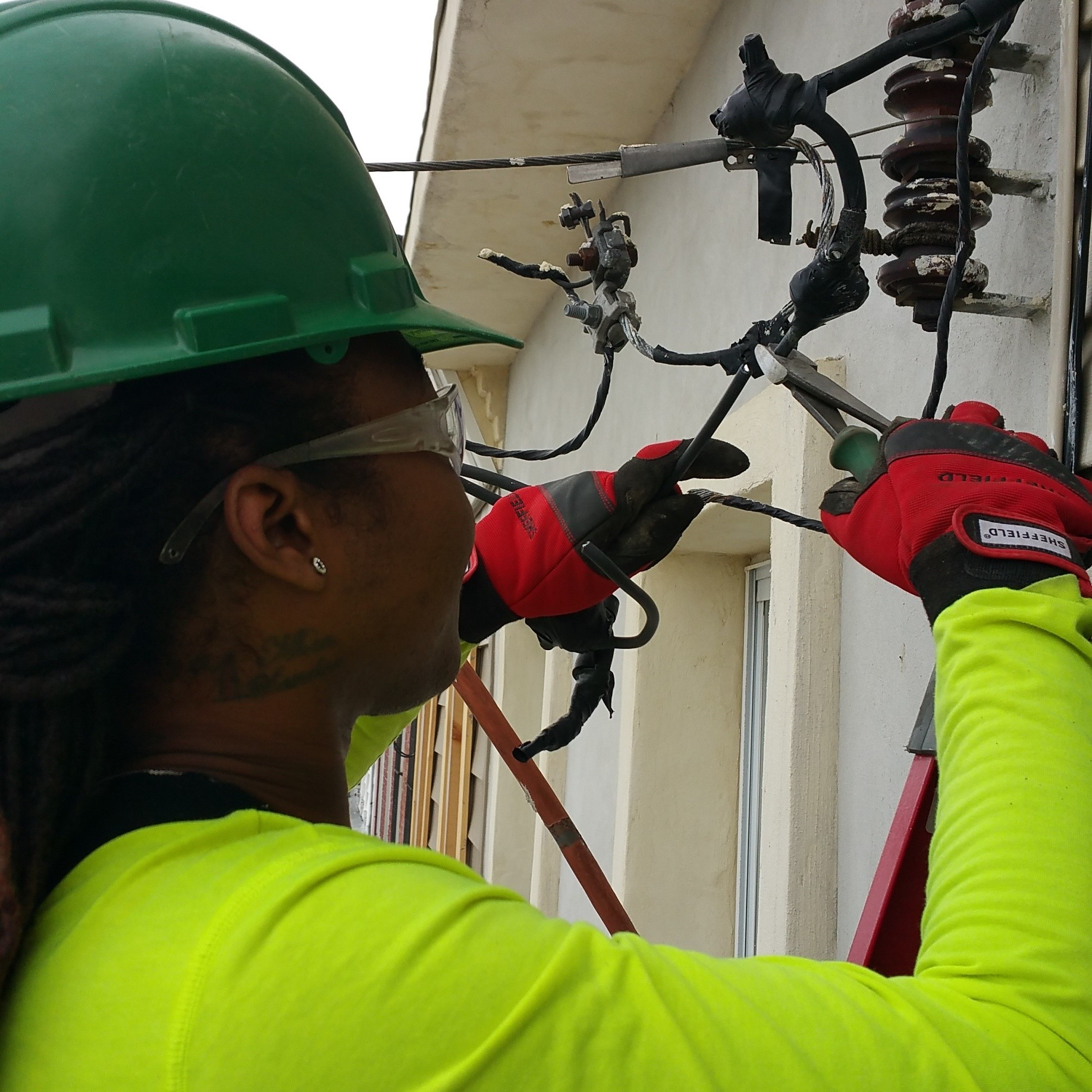

Monique Mobley, an electrical apprentice in Philadelphia, tying in a connection to the utility company. It's her first electrical service, 200 amps.
