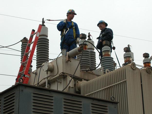

Photo 1. Qualified persons are often required to perform risk-filled tasks.

What is needed so that the Occupational Safety and Health Administration (OSHA) would consider your people “qualified persons” — that is, people who are exposed to electrical hazards 50V and greater (Photo 1)? This could be electricians, technicians, HVAC technicians, or any other person who works near 50V or more. OSHA doesn’t care about the job title. If your job title is “Chief Bag Carrier” and you work on or near exposed energized electrical conductors or circuit parts, you need to be qualified.
