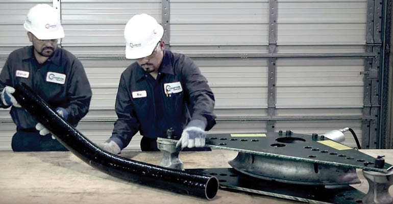

Field Bending
To bend RTRC in the field, you’ll need a hot box and a one-shot hydraulic conduit bender, an infrared (IR) digital thermometer and a contrasting marker, along with the usual safety equipment.
As per Sec. 355.22 in the 2017 National Electrical Code (NEC), “Bends shall be so made that the conduit will not be damaged and the internal diameter of the conduit will not be effectively reduced. Field bends shall be made only with identified bending equipment. The radius of the curve to the centerline of such bends shall not be less than shown in Table 2, Chapter 9.” You should also check the manufacturer catalog to verify the specific bending radius selected.
Select the proper size hot box based on the outside diameter of the conduit and the length of the bend.
Mark the center of the bend for easy reference later.
Put the conduit in the hot box and begin heating it. Rotate the conduit by hand with the wheel on the hot box until it reaches the proper bending temperature. Refer to the manufacturer’s specifications for proper temperature range. Verify the temperature with an IR digital thermometer.
Once the conduit has been heated, carefully remove it,and put it in the one-shot hydraulic conduit bender before it cools down. Make sure the center line mark is aligned with the center of the bending shoe. Refer to manufacturer guidelines for proper shoe size selection.
Bend the conduit to the desired angle, and check the angle using the ram travel scale on the bender. After reaching the desired angle, the conduit will need to cool in the bending shoe to retain its new shape. The cooling process can be shortened by using a cool wet rag or running cool water over the bent elbow prior to removing it from the bender.
Release pressure on the bender, remove the conduit, and verify its fit/condition. Note that you might need to make slight adjustments to the bend. If so, vary the selected radius on the bending shoe or adjust the temperature on the hot box, and repeat the above process.
