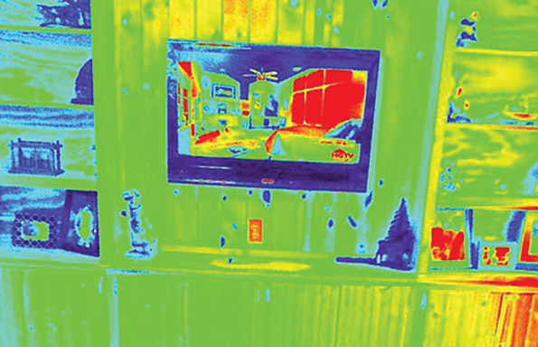

Photo 2. A thermal image camera app simulates the view of an infrared motion detector.

Now that we’ve discussed the technical aspect of the operation, let’s discuss how you can actually simulate what these devices see. In today’s world, we have tools at our disposal that were not available in years past. A simple thermal camera app on a smart phone or tablet can shed a lot of light on this explanation because a thermal image camera also works in the IR spectrum. Keep in mind though that these apps only simulate what a thermal camera sees and do not truly reflect what a high-priced camera would see. It does, however, give a representation that can be used to explain how these devices work.
First, let’s look at a normal camera view of a dog lying on the floor (Photo 1). This picture represents a long-haired dog that has been in the house for a long period of time. The room has a sliding glass door that allows ample light to come into the room. Now let’s examine what the thermal camera view looks like (Photo 2). The four colors in the image represent what an IR detector sees in its field of view. If you focus on the background (the cabinets), the sensor beams would be focused on the energy emitted from the wood. As someone or something passes in front of the cabinet, the IR energy within the field of view would rapidly change, causing the detector to trigger a signal. Notice the red shade close to the sliding glass door. This represents a different level of energy caused by the sun. If the door was opened slightly and a strong wind blew into the room, the blinds would move, which, in turn, would change the energy sensed by the detector. This same effect can be caused by having a PIR motion detector placed close to an HVAC duct.
