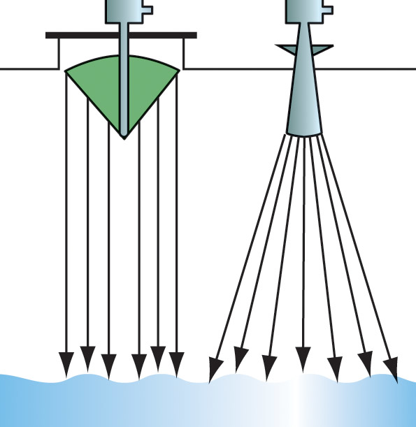

Fig. 1. Radar and ultrasonic measurement devices use reflective and absorption of radiation techniques to derive fluid levels in containers.
