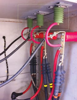

Photo 2. These pre-installed coupling capacitors are designed to detect PD events.
Online partial discharge tests are performed at the fixed operating voltage level. To perform online tests, suitable PD coupling methods are required. Over the years, different sensors have been developed to detect PD events. The online coupling methods at switchgear can include:
• Capacitive coupling via pre-installed, coupling capacitors (Photo 2)
• Capacitive coupling via already existing taps at current transformer, bushings (capacitive interface for voltage sensing/ voltage detection system).
• Inductive coupling using radio frequency current transducers (RFCT).
• Transient earth voltage sensor (TEV).
• Ultrasonic.
