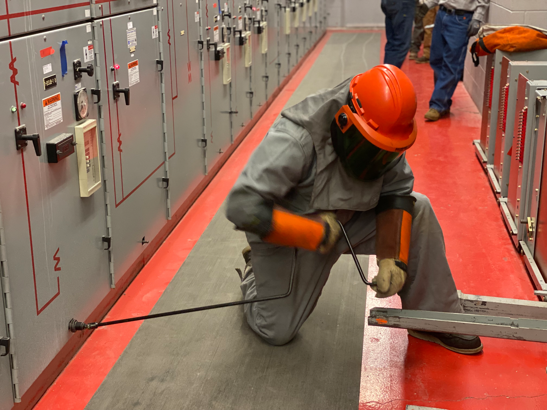

In the not-so-distant past, electrical workers routinely racked out breakers in the normal course of their jobs. They did this with little concern or knowledge of the hazards to which they were exposed. While all of us are more educated and knowledgeable today, many electrical workers still prefer the expediency of putting on a 40-cal suit over taking advantage of other available solutions.
Today, there are state-of-the-art remote racking and switching systems that allow a qualified electrical worker to interact with circuit breakers from a distance outside of the arc flash boundary. This is a big step in reducing safety risks related to arc flash. Remote racking systems require a significant investment and take time to learn. This can lead to them being under-utilized in cultures that fail to understand the consequences of an arc flash and the available strategies to mitigate arc flash severity and exposure.

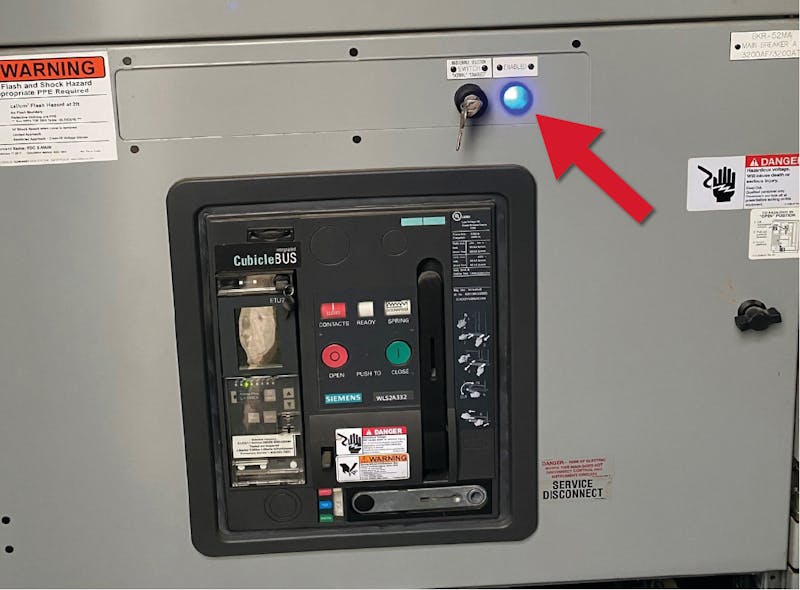

Clearing faults quickly and at lower current values is the theory of operation behind maintenance bypass switches. As an example, to maintain system reliability, an instantaneous trip on a low-voltage main circuit breaker may be set to 32,000A (eight times the rating of a 4,000A breaker). This setting is great for reliability, but not for safety.
While racking a breaker in or out in a maintenance situation, the switch is used to turn on an alternate group of settings. In this alternate group of settings, the instantaneous value is changed to a lower setting. This means that instead of 32,000A, the breaker could trip instantaneously as low as 6,000A (depending on trip unit type). This reduces the amount of fault current necessary to activate the instantaneous element as well as eliminates the time delay to clear a fault, should one occur.
Testing these systems is straightforward. Test the breaker at its normal settings. Place the switch in maintenance mode. Verify the settings group changes. Verify that the breaker operates at the lower current setting. An important final note for power system reliability: Always remember to return the maintenance bypass switch to its normal position (Photo).

  3. Apply safeguards. Use remote racking and switching to put distance between people and hazards.

In contrast to other systems, the use of remote racking and switching is easier to implement. Depending on the manufacturer, no outages or gear modifications are required, and the training can be done on the job. By modifying how these common system tasks are accomplished, qualified workers can now remove themselves from the arc-flash boundary and still perform their jobs. For example, opening or closing or racking breakers in or out can be performed outside of the arc flash boundary or even from another room.
