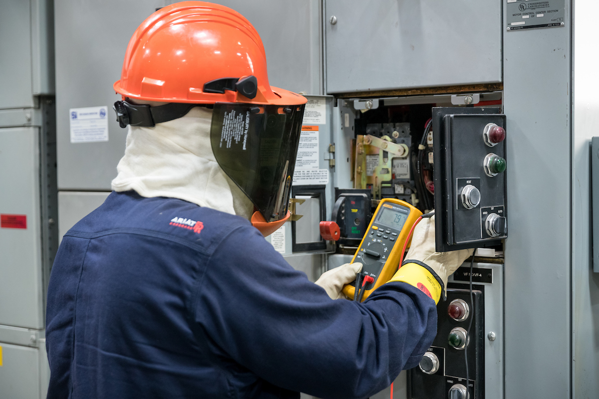

To identify the condition of an MCC, maintenance personnel should routinely conduct several checks following the manufacturer’s guidelines. These can be invasive or non-invasive tasks from simple visual checks to more complex analyses. It is important to conduct checks to establish cleanliness, verify software, and check/back up the operational parameters on programmable logic systems. Records of these parameters must be up to date. Maintenance personnel can conduct visual inspections to look for indications of overheating at terminations and conductor insulation points. In the absence of any direct guidance, NFPA 70B Chapter 16 can be used to initiate a starting point in establishing a basic motor-control maintenance program.

The goal of routine maintenance is to restore the MCC to its original condition. Any components that show signs of wear and tear can be serviced and/or replaced. Common routine maintenance tasks recommended by major manufacturers include:
  • Operating mechanism. Check for proper functioning and freedom from sticking or binding. Replace any broken damaged or badly worn parts or assemblies. Check all mechanical fastening devices, and return to the manufacturer’s specified torque values.
  • Contacts. Check contacts for excessive wear and dirt accumulation. Discoloration and slight pitting are acceptable. Do not use files to clean contacts. Do not use contact spray cleaners as they leave a residue that can cause sticking and/or interfere with electrical continuity. Replace contacts only after the silver has become excessively worn. Always replace contacts in complete sets to avoid alignment issues and uneven contact pressure.
  • Terminals. Loose connections can cause overheating that can lead to equipment malfunction and failure. Verify the tightness of all terminals and busbar connections to ensure these mechanical fasteners meet the manufacturer’s recommended torque specification. Replace any components or wiring damaged by overheating. Check the grounded conductor, equipment grounding conductor, and grounding electrode conductors for proper termination tightness.
  • Coils. If a coil exhibits evidence of overheating (cracked, melted, or discolored insulation), it must be replaced. Check for and correct any detected over- or under-voltage conditions, which can initiate coil failure. Clean any residue of melted coil insulation from all other parts of the device. If it can’t be sufficiently cleaned, it may be necessary to replace those contaminated parts or assemblies as well.
  • Pilot lights. Replace any burned-out lamps and/or damaged lenses.
  • Solid-state devices. Solid-state devices require little more than periodic visual checks. Ensure that the printed circuit boards are properly seated in edge connectors. Board-locking devices must be in place. If electrically operated venting is incorporated, verify fan operation, and replace any associated filters.
  • Locking and interlocking devices. Check proper operating conditions and capability to perform intended functions.
  • Environment and physical condition. MCCs are often physically located in areas that allow animal habitats to be established, increasing the danger of vermin being present. This can cause damage or even destruction of cabling and terminations. Qualified staff should conduct routine visual inspections of the physical condition of the equipment. Once identified, the situation can be rectified to restore the MCC to its proper operating state.
  • Replacements. Make any necessary replacements only with OEM materials. Ensure parts are properly matched to the model, series, and revision level of the equipment.
  • Final checkout. After maintenance or repair of industrial controls, always test the control system for proper functional operation under controlled conditions that avoid any hazards associated with a control malfunction.
