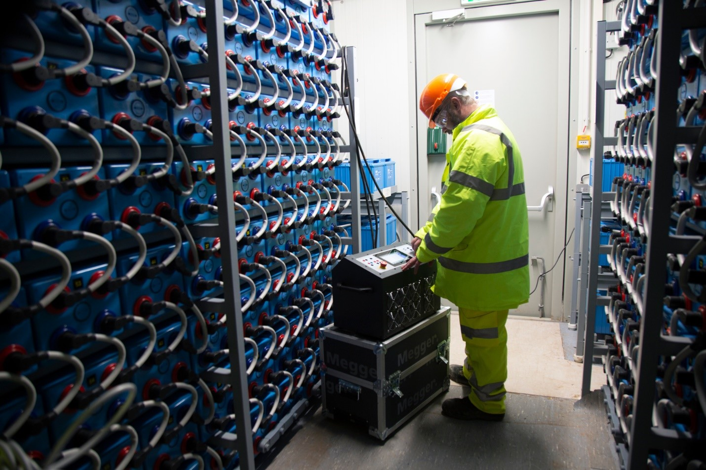

Photo 1. Wearing the correct PPE ensures the safety of testing personnel.

Safety is essential
Before getting into the steps that can be taken to ensure a smooth discharge test, it is important to cover the safety aspect. The tester must be well-equipped to carry out the test in a safe manner (Photo 1). Personal protective equipment (PPE) includes safety glasses, face shields, acid-resistant gloves, and a protective apron. The presence of a water facility for rinsing eyes and skin after coming in contact with the electrolyte, a Class C fire extinguisher, and adequately insulated tools will ensure the safety of testing personnel.
