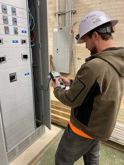

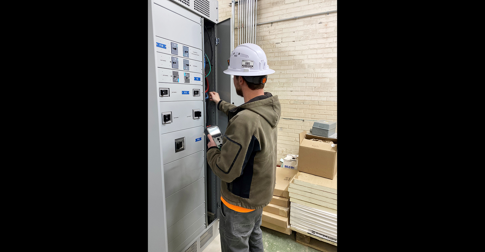

Before Freedom ElecTech could connect the new electrical service to the existing feeders, the engineer first needed to know the exact size and length of the feeder wires. These wires were installed in conduits under a concrete slab of the existing building.
Without tracing the wires throughout the existing building, there was no real way to know exactly how they were routed to accurately measure them. Since most of the wires were inaccessible, it would have been very time-consuming to collect the data the engineer needed to perform the study. Therefore, the team used a portable time domain reflectometer (TDR) to accomplish this task.
“It was a perfect solution for us. It was the only piece of equipment we found capable of accurately measuring the cables,” Caviness said.
The TDR provides fast and accurate results when uncovering transmission-related problems, testing the physical integrity of cables within a network, as well as identifying faults on secondary power cables. “The remodel job, which took about three years, is now complete,” Caviness. “The part of the job that used the TDR only took about 6 hours. Once we had the right tool to measure the cables, things were smooth sailing.”
