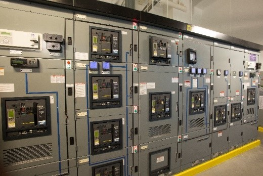

Courtesy of QTS Data Centers
Data centers practice maintenance testing and require at least one of the arc flash mitigation methods.

Arc flash reduction methods must be considered before working on energized electrical equipment for personnel safety. The idea behind energy reduction is to place energized electrical equipment in a state where less arc energy is available when an arcing fault occurs. These techniques range from the obvious (de-energize!) to more complex and costly engineering solutions.
Section 240.87 of the 2011 NEC, initially titled “Noninstantaneous Trip,” was added to address breakers without an instantaneous tripping function to trip breakers with no intentional delay. In the 2014 NEC, the title changed to “Arc Energy Reduction” with the intent to improve worker safety by reducing the arc flash incident energy (AFIE) on a circuit breaker that can be adjusted at 1,200A or higher.
Section 240.87 of the 2020 NEC lists seven methods to reduce arc flash energy — whether in initial design/construction or on a retrofit project. Each of the seven methods comes with pros and cons. Let’s take a look.

Method 4 – energy-reducing active arc-flash mitigation system
This is one of several special systems that automatically limit the energy released during an arc-fault event by one or more detection means (see Figure). The following lesser-known concepts are based on NFPA 70E, Standard for Electrical Safety in the Workplace, Annex O:
  • One concept reduces the arc duration by creating a low-impedance current path for the arcing fault, allowing the upstream breaker time to clear the fault. Essentially, this method forces a bolted fault on the circuit, which transfers electrical energy to a new path, causing the upstream breaker to operate with no intentional delay.
  • Another concept is to use an arc-flash relay with two components: light sensors to detect the light produced by the arc-flash event and a current sensor (typically a CT) to detect the sudden rise in overcurrent. These two components, when detected simultaneously, send a trip signal to the protective device to operate without intentional delay.
  • Another solution is an energy-reducing line-side isolation barrier enclosing the line-side conductors. This option protects workers from both shock and arc-flash events on the line side of the protection device.
  • Arc-resistant equipment can also be used to divert arc energy away from personnel.
Pro: Design can be specific to the end-user or specific application.
Con: Can get pricey from concept to design, installation, and testing.
