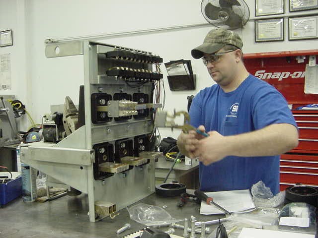

Photo 1. A technician working on a Westinghouse low-voltage power circuit breaker.

While LVPCBs were the industry standard for years (Photo 1) and insulated-case circuit breakers have, for the most part, taken their place in the industry, there are still thousands of LVPCBs still in operation. You need to understand their operation and maintenance requirements if you encounter them in the field.

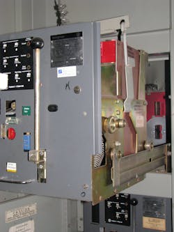

Circuit Breaker Lifting Bars
Photo 3a shows the lifting bars from one manufacturer, but they are all similar in the way they work. Photo 3b shows a typical LVPCB ready to be lowered properly by lifting it off its extension arms. The circuit breaker rollers must be checked before they are rolled out of their cubicle to verify they are on the extension arms and attached properly to the circuit breaker. The cable is just out of sight in Photo 3b. It has been unwound from its reel and rewound, so it is straight — and any wound cable does not overlap.
Be careful when attaching the lifting bars to the carriage of the circuit breaker. It’s easy to see in Photo 3a that, as one side is attached, the other side may release.

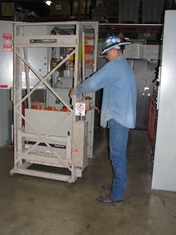

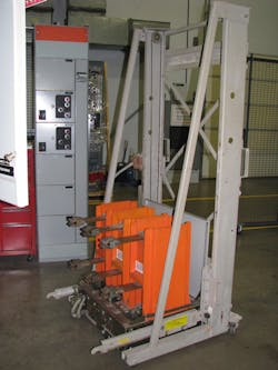

Lift Platform
It’s no fun seeing a circuit breaker hit the floor. If no cable mechanism is available, a hydraulic lift or mechanical lift platform can help you prevent this from happening. As Photo 4a and Photo 4b show, many medium-voltage manufacturers supply such a lift to install and remove their equipment. The equipment is de-energized, and the technician is wearing the correct PPE for this task.
