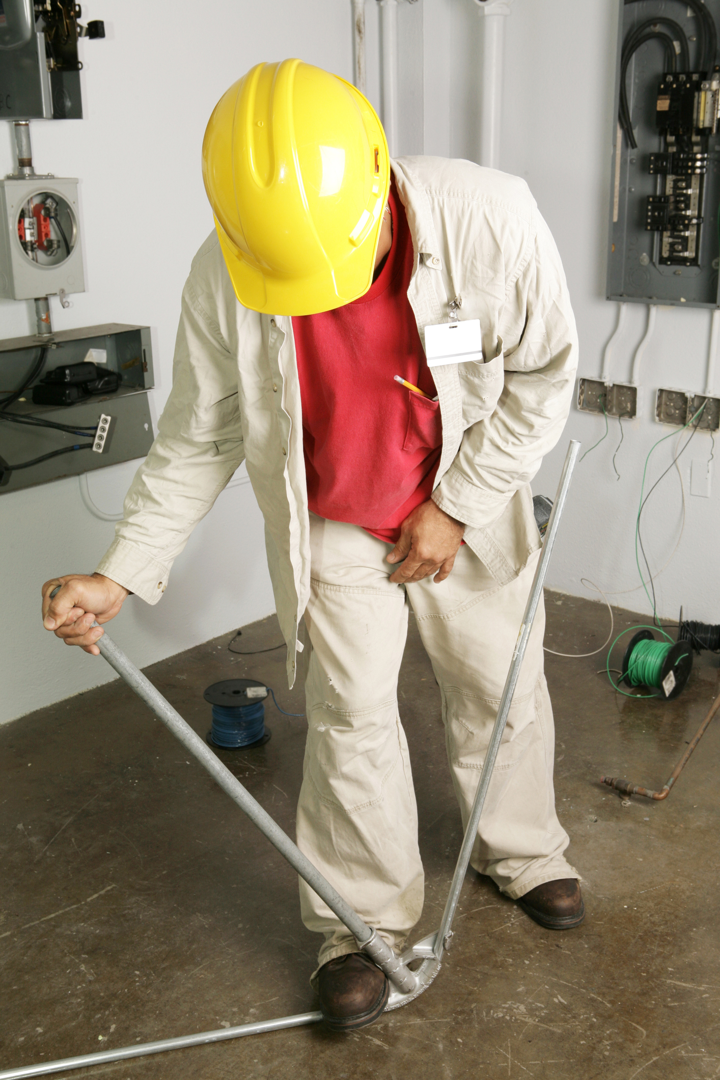

Step No. 6: Make the bend
If you’re using an electric bender, place the raceway in the shoe and adjust its position to align with the marks you made. Then make the bend. If you’re using a manual bender (“hickey”), go back to that wall you made friends with earlier. Set the raceway on the floor with the "start" end against that wall. Slide the hickey over the free end. Align the raceway "bend" mark with its counterpart on the hickey. Pull gently on the handle and increase force as it starts to move. Apply steady pressure through the bend, reducing that pressure as the raceway approaches the desired angle. This method avoids introducing hysteresis into the metal, something that happens when you bend it back and forth to get the desired angle.
