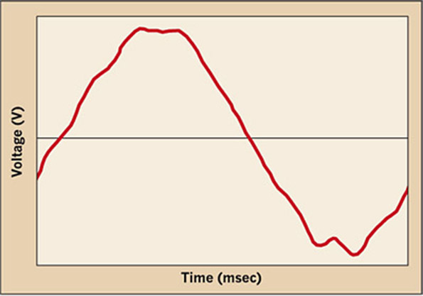

A good harmonic analyzer will show you graphically the breakdown of your component harmonics.

A good harmonic analyzer is easy to use and will show you graphically the breakdown of your component harmonics in addition to other information such as your Total Harmonic Distortion (THD). The component breakdown is essential if you want to understand your harmonic distortion picture.
