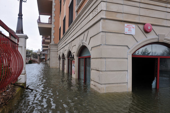

Serious flooding in the buildings at the Sheapsheadbay neighborhood due to impact from Hurricane Sandy in Brooklyn, N.Y. (Photo by Anton Oparin / Shutterstock.com)
