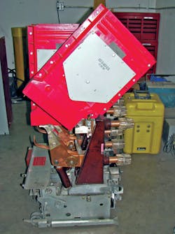

  1. Arc chutes or vacuum bottles (extinguishers or interrupters).
  2. Backboard assemblies and/or pole units (primary insulation).
Photo 2. Typical medium-voltage arc chute in the open position.
Arc chutes (Photo 2 at right) are one of the most critical elements required to extinguish the arc. Arc chutes must stretch, cool, and contain the arc, even during short circuits. Any defect in the arc chute could cause a restrike — a condition in which the arc re-establishes itself. If a restrike occurs, the circuit breaker cannot clear the fault, and the next device upstream has to operate.

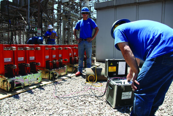

Let’s review the three most common DC tests used to verify the integrity of the insulating components of a breaker.
1) DC overpotential test — The DC overpotential test is one of the standard tests recommended by ANSI/NETA MTS-2011. Placing a high DC voltage across a circuit breaker’s insulation system stresses it so that moisture, dirt, tracking, and weak insulation can be detected. For low-voltage power circuit breakers, you can use a 2,500V megohmmeter for this test. Medium-voltage circuit breakers require the use of a high-potential test set. ANSI/NETA MTS-2011 Table 100.2 gives guidance for overpotential testing of low-voltage circuit breakers and switchgear, and Table 100.19 can be used for medium-voltage circuit breakers and switchgear.
In general, when performing an overpotential test, no specified value is used to evaluate the insulation. If the insulation shows no sign of failure, it is considered serviceable. This is often referred to as a “proof test” or a “Go, No-Go” test, because there are no specific values in ANSI/NETA MTS-2011.
Table 1. Test connections for the DC overpotential test.
Test connections for the DC overpotential test are given in Table 1 (right), which will provide a test of all possible leakage paths in the circuit breaker. Table 100.19 from ANSI/NETA MTS-2011 provides recommended test voltages for proof testing and field testing medium-voltage power circuit breakers and switchgear (Table 2).

2) Insulation resistance test — An insulation resistance test on low- and medium-voltage circuit breaker’s primary insulation will show gross defects, but to discover tracking, deterioration, and moisture, a DC overpotential test or an AC insulation power factor test is recommended. This is not to say an insulation resistance test should not be performed at all. It can be used for performing a safety check before the breaker is returned to service, and it can also be used to test control wiring,
current transformers, and potential transformers. ANSI/NETA MTS-2011, Table 100.1, provides guidelines for insulation resistance testing of non-inductive electrical equipment, which would include control wiring.
Caution: When performing insulation resistance tests on control wiring on circuit breakers, the high voltage must not be applied to the spring charging motor or solid-state overcurrent devices that may be connected to it. Make sure the device or circuit under test is properly isolated.
All control wiring should have its insulation resistance checked. Wiring that is even slightly out of position can be damaged by wear or cutting on sharp edges. 250V class wiring is tested at 500VDC and should have a minimum insulation resistance of 25 MΩ. 600V class insulation is tested at 1,000V and should have a minimum insulation resistance of 100 MΩ. Measure insulation resistance from the wiring to ground. On a circuit breaker, this would be the frame or chassis.
