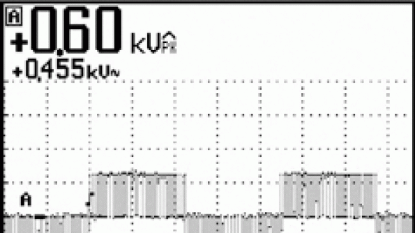

Analyzing Transient Reflections at the output of a VFD
VFDs control the speed of machinery and processes by varying the width of (i.e., “modulating”) the voltage pulses they send to motors. These voltage pulses, which are essentially square waves, have fast-rising edges that can cause transient voltage reflections in the cable between the VFD and the motor. Many factors affect the size of the reflected waves, including cable length, motor load, the surge impedance of the cable and motor, and the rise time, spacing, and magnitude of the drive pulses. Over time, these reflected wave voltages can place too much stress on cable and motor insulation, which can cause either to fail.
Making voltage measurements with a DMM can reveal excessive voltage at the motor terminals when transients are present. To check the voltage, connect the multimeter at the motor terminals between phases L1, L2, or L3. Although you can use a DMM to measure the peak voltage of a pulse width modulated (PWM) signal, the limited bandwidth of the typical DMM makes measuring pulses with short rise times problematic. Therefore, the readings may not provide the complete picture of the presence — or full amplitude — of any reflections or transients. Unfortunately, even the best DMM can’t show you what the waveforms actually look like.
Oscilloscopes display a signal as a line that moves across the screen from left to right. The higher the voltage, the higher the signal appears on the oscilloscope screen. Measurements made with an oscilloscope reveal not only the presence of excessive voltage at the motor terminals, but also give you a clear picture of size, location, and duration of any voltage transients.
To take a reading with an oscilloscope, connect the scope to the motor terminals between phases T1, T2, or T3, just as you did with the multimeter. An ideal PWM signal with normal peak voltage will look like the waveform in Fig. 1. If high-voltage transients are present from voltage reflections in the cable, then the waveform will look like it does in Fig. 2. These voltage reflections are often caused by improper cabling.
