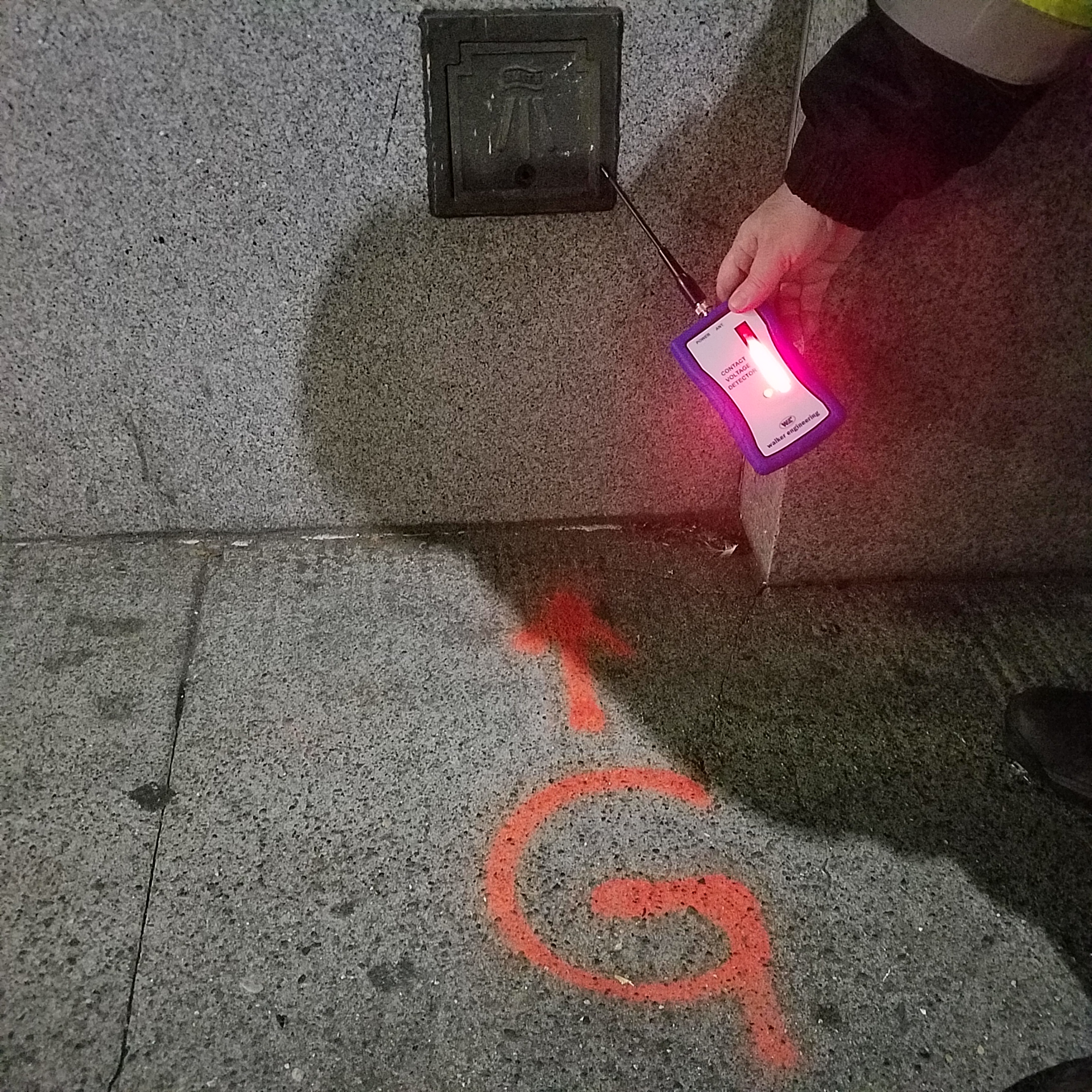

Photo 1. In this situation, the testing contractor should have immediately sought out a different qualified reference ground.

In this instance, it was the latter. Cycle 4 was the first time mobile survey technicians used a water bib on the outside of an adjacent building as a qualified reference ground. The same was true for the subsequent five testing cycles (i.e., the building’s water system was used as the qualified reference ground point). It was not until after Cycle 9, and a different set of eyes looking at the situation, that the voltage measurement error was identified.
IEEE 1695 features a well-developed flow chart on how to detect and quantify contact voltages. One of those steps includes a process to validate that the qualified reference ground itself does not have a preexisting voltage potential on it.
Photo 1, below, shows one of the methods the standard recommends to validate a qualified reference ground. In this instance, a handheld voltage detector is being used. The orange “G” on the sidewalk is the original contractor’s mark showing this was the water bib used as their qualified reference ground. The red LEDs on the handheld voltage detector indicate that the bib has voltage potential on it. The bib is located behind the metal security cover.

Because the building water piping itself was energized and was the true source of voltage, any conductive object the testing technician touched with the second voltmeter test lead would erroneously indicate that the object had a contact voltage on it. This explains the drastic increase in findings starting in test Cycle 4 — a change in the qualified reference ground over the previous three testing cycles. Thankfully, the utility decided to monitor this situation over time rather than immediately start a major upgrade to the underground electrical distribution system, which would have cost tens of thousands of dollars. This would have left them perplexed as to why the “fix” didn’t work during the next test cycle as the testing technician again used the same energized water bib as a qualified reference ground.
