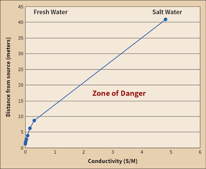

The authors decided to quantify what they have defined as a “Zone of Danger,” being the distance at which total body current exceeds 20mA as a function of water conductivity. This is shown in Fig. 3. The Zone of Danger (as defined here) is merely useful for comparison for defining risk of ESD as a function of water conductivity, placement of the swimmer, source, and ground.
The authors note that these simulations demonstrate what Dr. Morse has seen experientially through consultation, which is that ESD drowning can occur in both fresh and salt water as well as in pool water (where conductivity is typically
2.5 S/m to 3.0 S/m).
