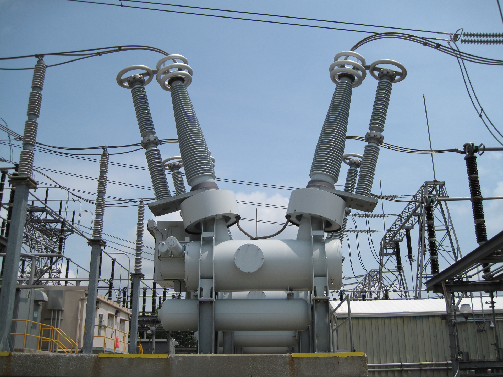

Tests were being performed on a 3-phase, 250kV circuit breaker (like this one) when the accident occurred.

The Scene
The breaker being tested was a single pressure SF6 circuit breaker. Note: Sulfur hexafluoride (SF6) is an extremely good insulator — roughly 2.5 times better than air. The breaker was equipped with transient recovery voltage (TRV) suppression capacitors. TRV capacitors also go by the name “snubber” capacitors, located on each of the three individual phases. In this particular case, each snubber capacitor was comprised of two individual capacitors connected in series with each other to act as a single larger sized unit. During the course of the test, the site remained dry and clean.
The Accident
The 450kV DC test voltage was first applied to Phase A on the “high” side of the bushing for 5 min. After Phase A successfully passed the test, the test voltage was removed from the high-side bushing and allowed to sit for 5 min. This rest period allowed the voltage to dissipate before re-grounding the high-side bushing. Using an insulated grounding stick, the technician then reapplied the ground to the high side of the snubber capacitor. The crew waited another 20 min. to allow the high side of the breaker for Phase A to fully discharge. However, no protocol addressed the center point of the two stacked capacitors.
In preparation for the same test on Phase B, one member of the crew (a lineman) was in a grounded lift bucket about 15 ft above ground. Handling the mechanical duties of making the connections ordered by the company’s engineer supervising the test, the lineman proceeded to remove the grounding cable from the high-side terminal of Phase A. According to eyewitnesses, it was at this point that a fairly large ball of light emitted from the midpoint location and struck the lineman. Only protected by leather gloves at this point in time, the lineman suffered burns and muscle/organ damage as a result of the accident.
Although the incident didn’t kill him, he experienced body tremors (e.g., the “shakes”) for several years after the accident as well as suffered from post traumatic stress disorder. Fortunately, he did not fall out of the bucket, but he did black out briefly yet remained at least partially conscious through the entire event. After lowering the bucket to the ground, the victim’s fellow crew members administered first aid until paramedics arrived minutes later.

It’s important to understand the electrical design parameters of the snubber capacitor arrangement in this particular case before diving into analysis details. This type of design creates the following three states:
  1. OFF or zero voltage state, when both the high side and low side of the snubber capacitor are grounded.
  1. ON state, when 450kV is applied to the high side of the snubber.
  1. The intermediate or transitional state between these two prior states. It is this intermediate state that is most dangerous to work on or near.
If a voltage spike occurs during the intermediate state, then electricity can jump across the ceramic insulators of the snubber capacitor and travel up to 30 ft in air. This arc can easily shock or electrocute someone, as was the case in this particular situation.
Upon closer examination, we made an interesting discovery. The circuit breaker was originally designed with a single body 2nF capacitor per phase, intended to handle voltage stress levels of up to 500kV DC without breakdown of the insulator. However, a new design engineer working for our client (manufacturer of the capacitors/breakers) later revised the circuit to employ two 4 nF capacitors stacked in series rather than a single unit. Carried out to save money, this approach was approved by the company design team for the “next generation” of breakers that it sold. Although this new design arrangement produced the same overall rating as the original single capacitor design, each stacked capacitor unit could now only be stressed to 250kV.
As a rule of thumb, the money spent on building a capacitor to operate safely at a specific voltage level will increase by at least a factor of four each time you double the maximum voltage stress rating of the capacitor. The reason for this is the cost must cover the construction needed to handle the higher power, and electric power varies as voltage-squared. Consequently, a design engineer can realize a big up-front equipment cost savings by decreasing the voltage stress level of a specific component.
In an ideal setting, two capacitors placed in series split the voltage applied across them evenly. Capacitors can be thought of as infinite ohm resistors, but the resistance of this arrangement can be many trillions of ohms. The problem with this type of design is the capacitor manufacturer cannot maintain strict control of the capacitor geometry. If the geometry between two units is off by a mere 1%, then this will create a major problem. In this case, a 1% deviation at 450kV is 4,500V. This is the voltage at the midpoint of the capacitors at the conclusion of the hi-pot testing, after the high side is grounded.
Our investigation revealed negligence on the part of the electric utility. The manual that came with the circuit breaker, as supplied by the manufacturer, specified that discharge of the capacitor(s) was to be done by placing all terminals (high, low, and middle) to ground. The work crew only had the high and low terminals grounded at the time of the accident. Furthermore, basic engineering principles show that when two capacitors are placed in series, full grounding does not take place unless all three terminals are grounded. Nevertheless, the crew (including both linemen and the engineers) overlooked the additional grounding of the midpoint of the capacitors. The linemen did not know it was required. The engineers never clearly stated what they believed before the accident; however, their instructions to the crew led them to believe that only the top and bottom of the two capacitors in series were sufficient to be grounded in order to make the arrangement safe.
